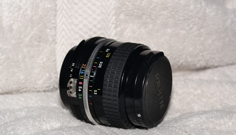

here is whats is on the lense. no problem with the pictures. but looks like it crystalized.

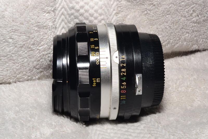

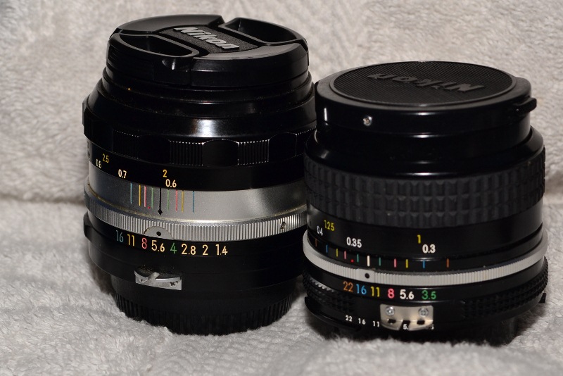

here's a pic with both lenses. 1st is 50mm, 2nd is 28mm
I've heard that you should store this lens apart from the others to prevent the fungus to migrate. I have no clue if it could happen or not, but better be careful than sorry.

that 28 is supposed to be one of the sharpest lenses ever produced. I wouldn't worry about the fungus but would get info on how to stop it if that's even a possibility.

Yeah, that's definitely fungus, not moisture. The lens has to be removed and cleaned, otherwise it will just keep growing. It's worth the small cost to have it done professionally. That's an awesome lens......well worth preserving. The silica won't help this problem.

Definitely contact your local camera store and see how much they would charge to clean your lens. It may not end up being such a small cost, but still worth checking into. I about choked when I heard what some of these stores charge for this service. I'm in the wrong business.

The 28/3.5 is about the cheapest Nikkor in the universe...cheap NOT cheaply made! They are full blown Nikkor quality. You can get an excellent plus non AI for less than 50 bucks...read easier to just replace then to have repaired besides most of the time fungus "etches" a lens. I would segregate it most definately but that is just me.

Here is something you might do with that new wide angle Nikkor of your's...I took a gander at mine tonight and looked at that photo of your's and I think this might be a possibility for you...
From your picture I gather that your fungi problem is on the front element of your lens...looking at mine it appears that it would be very simple to remove the front element if one had a spanner wrench (see link following...there are cheaper ones available too I think) Spanner Wrench, Lens Ring Tool
Basically you pop off the front element and clean it up...DIY You don't have much to lose and a lot to gain! :)
It is just my way of thinking but I would keep that lens away from my camera body...more so than my other lenses...until I was able to get it cleaned up.
