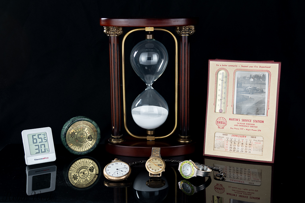

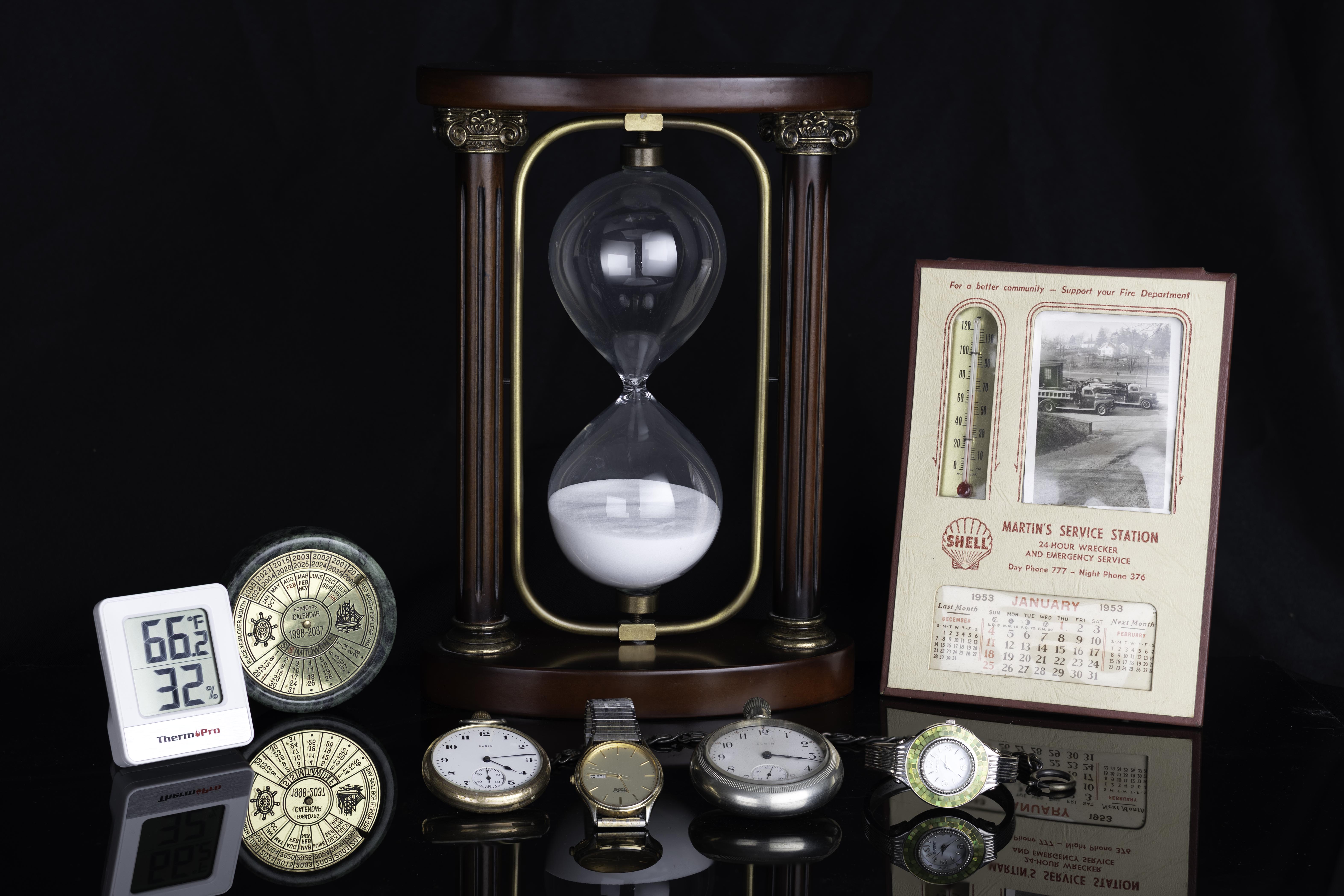

Yes, I am using the start in the menu because it won't work from the shutter button. This is the photo that I would like to stack..

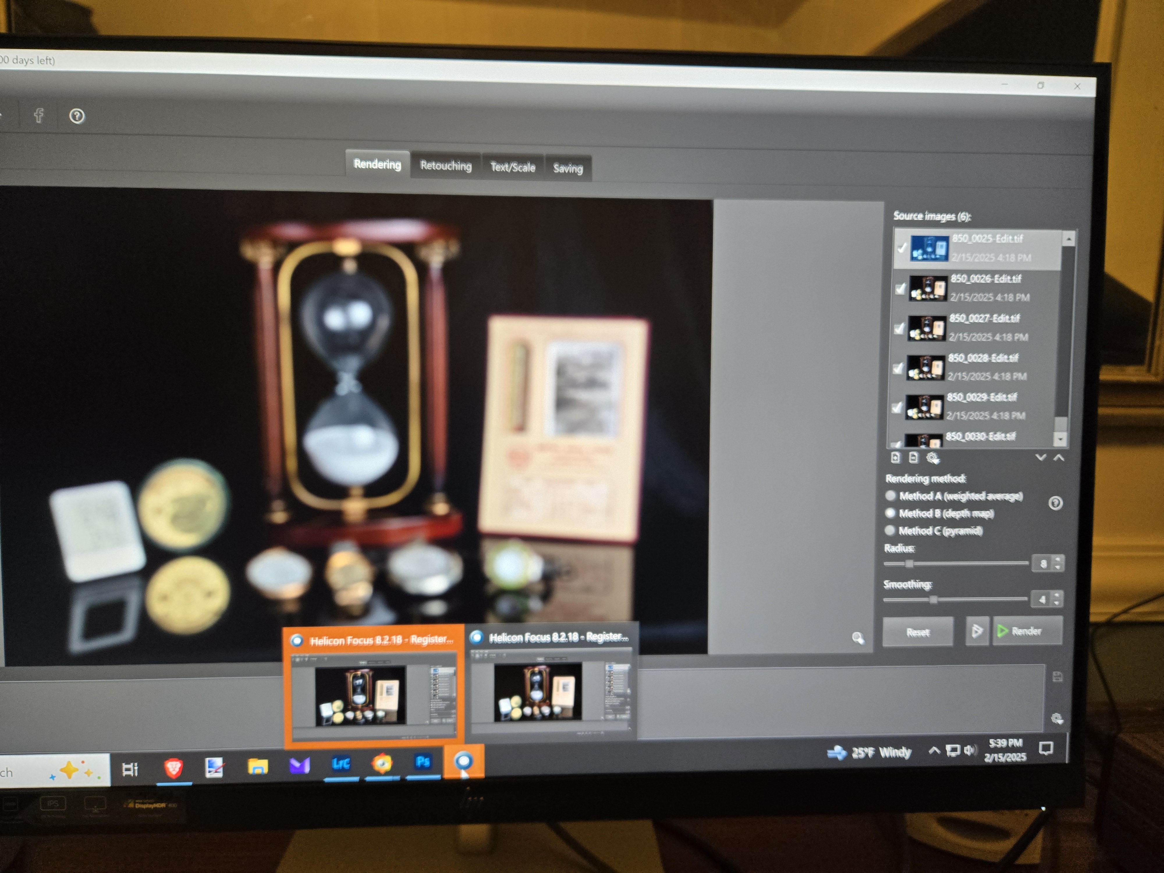

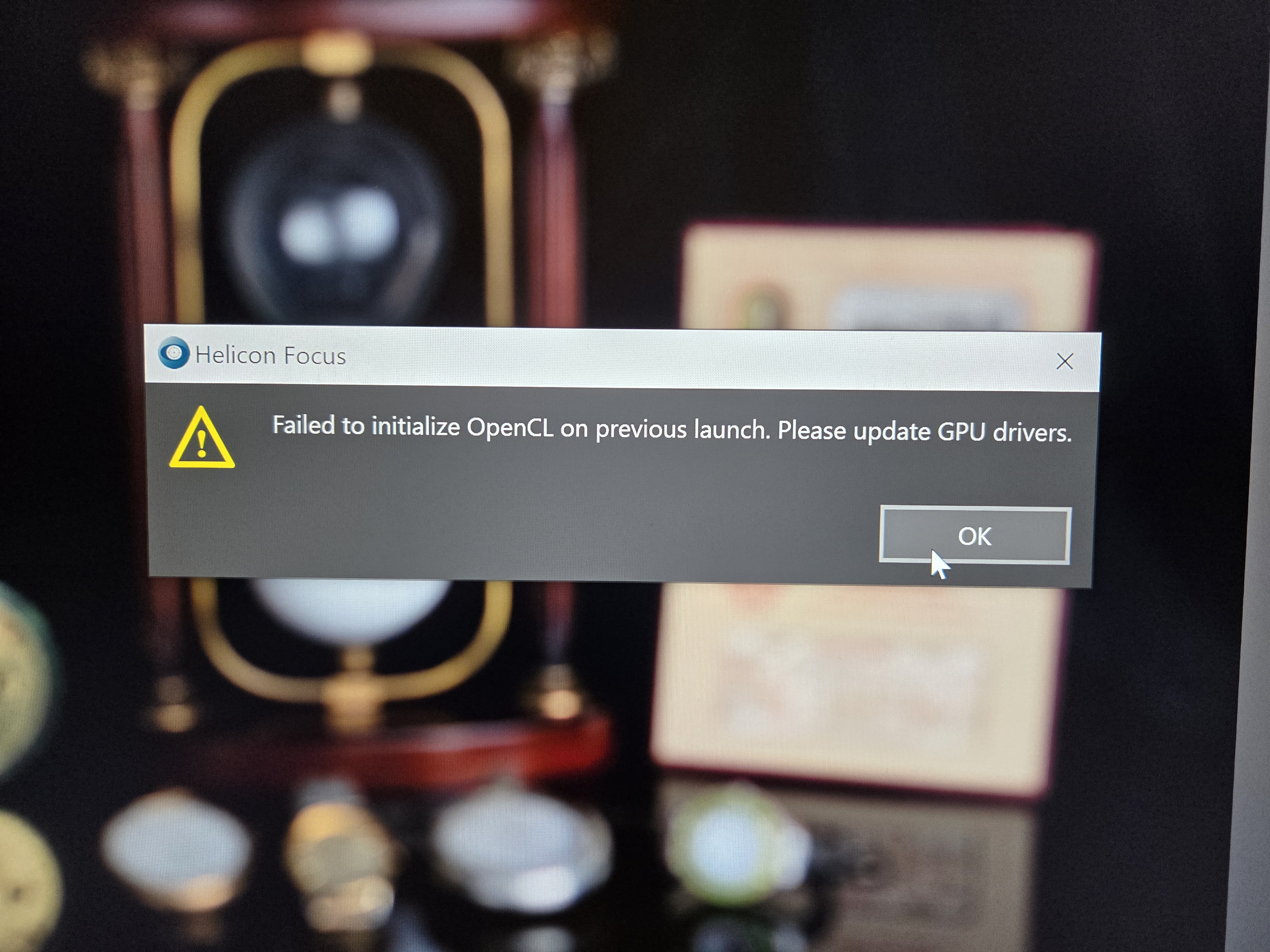

You are much steadier than I am. I have done that with bugs, not with that much success. But I do want to learn how to use the feature since that was the main reason for buying the camera. I think I figured out the problem. I was using the wrong lens. I was using a Nikon AF-S Nikkor 24-120mm 1:4G and I couldn't open the aperture enough to make the width steps small enough. Once I changed the lens to a AF-S Nikkor 50mm 1:18G I was able to get good results. However, now my Helicon Focus software will not load the photos. One problem after another. It asked me to update my GPU drivers, which took me about 2 hours to figure out, but I got them updated. Now when I send photos from LR to HF it opens HF 3 times and tells me to update my GPU driver again. I have no idea how to fix that problem. I have submitted a request to HF for assistance. I will probably try using PS for the stacking and see how it goes. Hopefully PS still works.

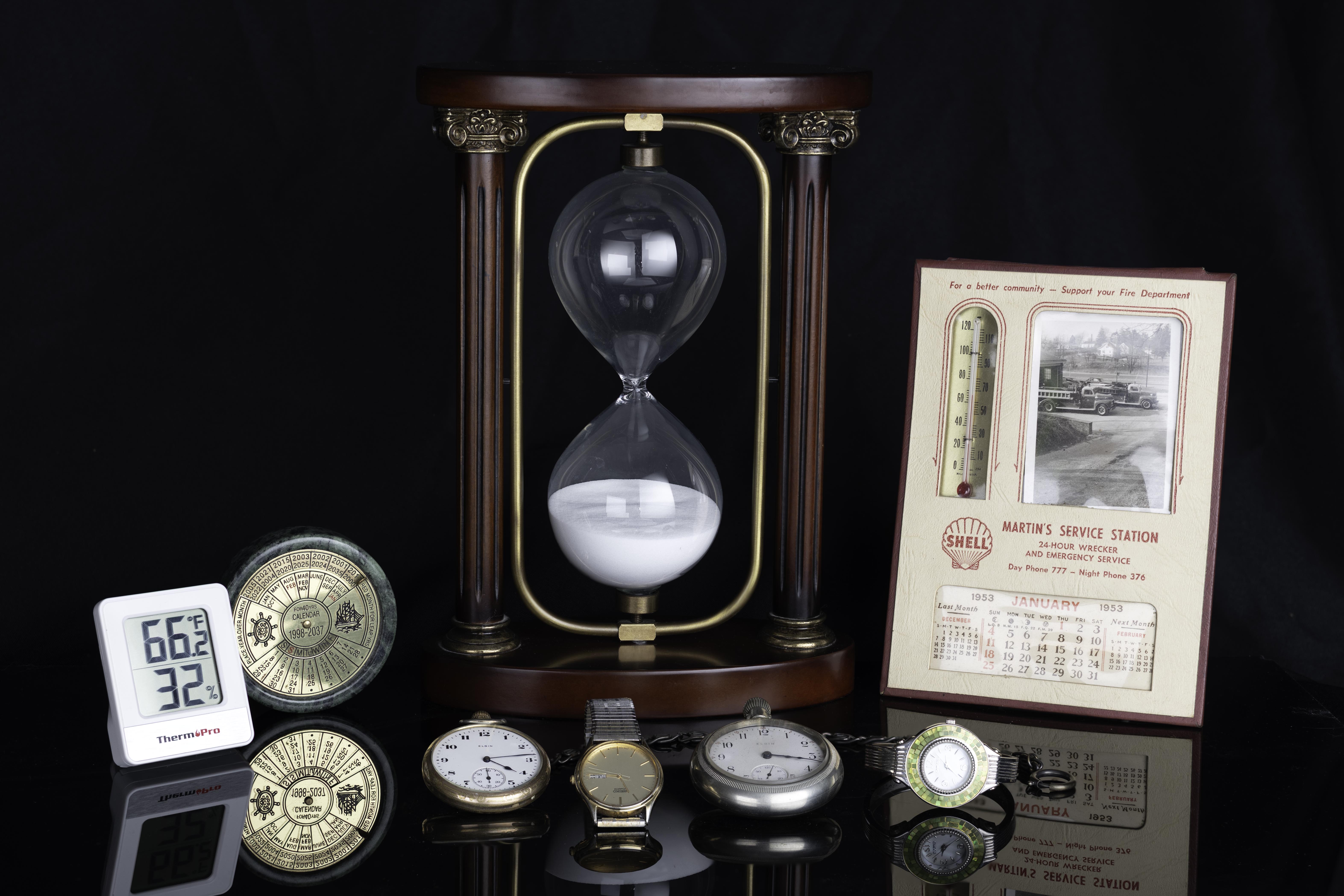

You can see by this photo the lens made a huge difference. I was able to get 29 photos where before it was only taking 12 and most of those were focusing behind the subject. This photo has some problems that I fixed. I retook the photo and was able to get 30 photos but since HF is not working properly I will have to wait to see how I did. And now this site will not let me post without it being a link. I probably should give it a rest for a while. I tried it in PS but the results were awful.
