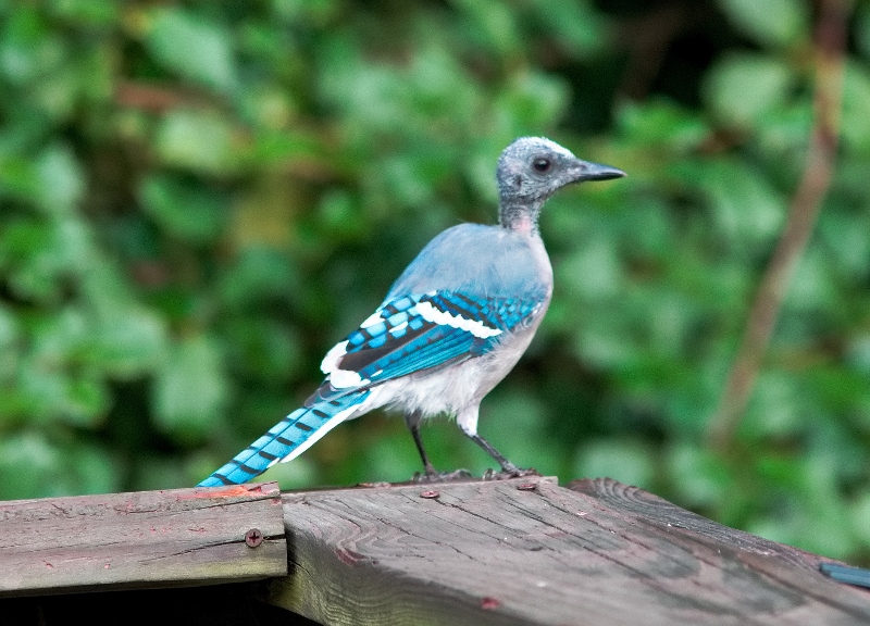

I have a D7100. My focus is not sharp. Soft I guess. Did I do something? LOL....I know I on occasion hit things I didn't mean to. What's the best way to check this? I've got nothing saved....can I just reset the settings? (I believe I've seen people suggest this).
Now this is my Tamron 70-200 2.8. Before I could see extreme detail of a bird. I bought this lens as a refurbished and thought maybe whatever was the reason for original return, returned. I have approval to send it back but then I thought I should make sure it's the lens.

It's hard to be 100% certain but it appears to me you MIGHT have a little front-focusing going on in the bird shot. Notice how the screw-head and tail feathers appear sharper than the bird's head? That's what I'm basing my suspicion on. It's not a lot to go on (your images are 600 x 400 so they don't resize well) and I could very well be wrong but have you checked/calibrated your lenses for front/back focus?

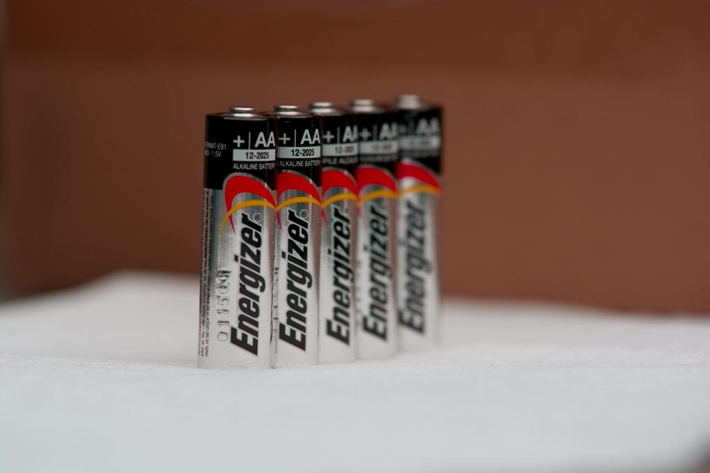

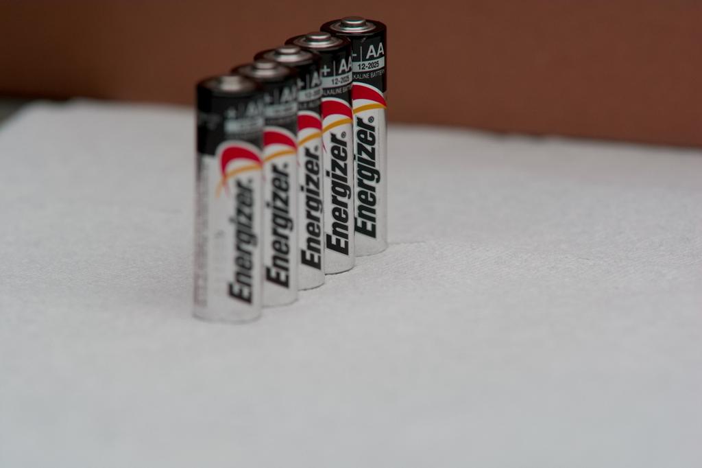

O.K.....I can be a little slow and dense....lol, but I focused directly on the center battery. It appears here the focused ended up back focused. Should I do this for multiple focus lengths?
I agree. That shot is clearly back-focused. I would adjust that lens to about a -7 and see where that get's you.
To be thorough, yes; you should test at both the minimum and maximum focal lengths. Hopefully things won't go massively sideways on you... They could, but they shouldn't.

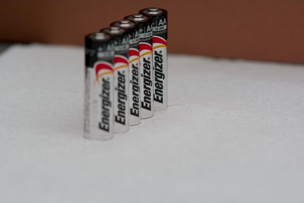

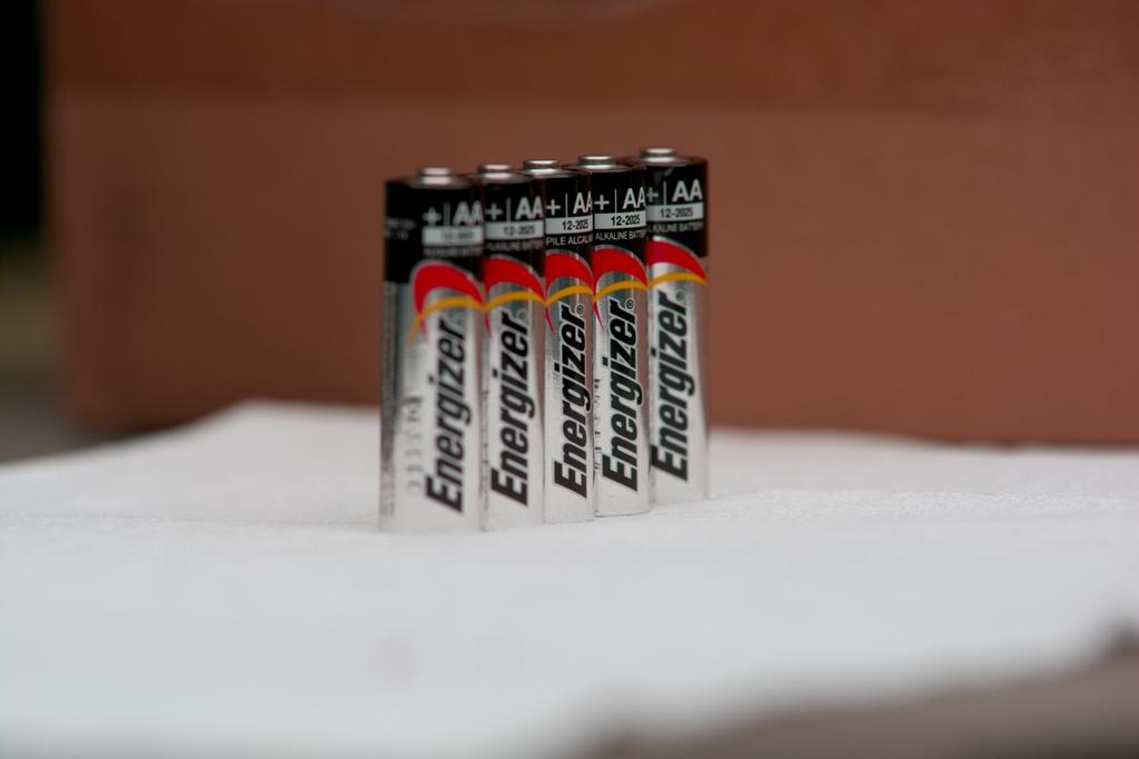

Obviously I went too far with -7 and I understand this concept and how I need to do this under controlled settings (obviously the camera has moved) but how does the focused part look out there? I have an older laptop that isn't the best as far as screen resolution goes. Sometimes my pics look so-so but I get on a different computer and they look far better. (I have a better computer, the laptop is just far more convenient)
The in-focus part of that shot looks very good. So that's good news, the lens *IS* taking sharp shots, you just need to get the Auto-focus dialed in.
Focus calibration in a bit of a pain in my opinion but the better the camera, and the better the glass, the more it needs to be done. It'll all be worth it in the long run.
Question, though... Are you shooting RAW or JPG? If you shoot JPG have you adjusted the Sharpness setting in the Picture Controls menu?

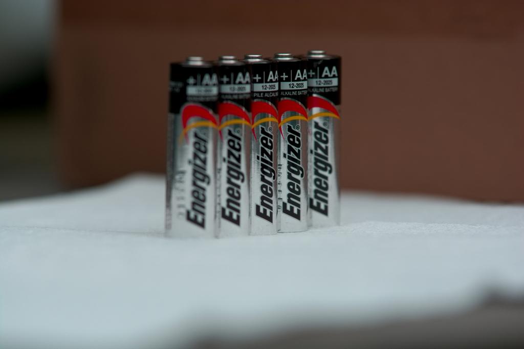

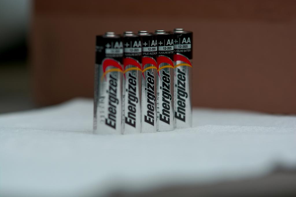

I went -4....looks like I need to go -5, take some pics....see how they turn out and then go through all of this correctly with all of my lens. (Shooting Raw). I made no adjustments when I converted to JPG.
That's a big improvement, and looking pretty spot on, I'd say... ^^^
Since that's an unsharpened RAW/straight to JPG image, I'd think a light touch of sharpening would really make it pop.
I'd suggest getting the AF dialed in at one specific focal length and then see if that adjustment looks just as good at other focal lengths.

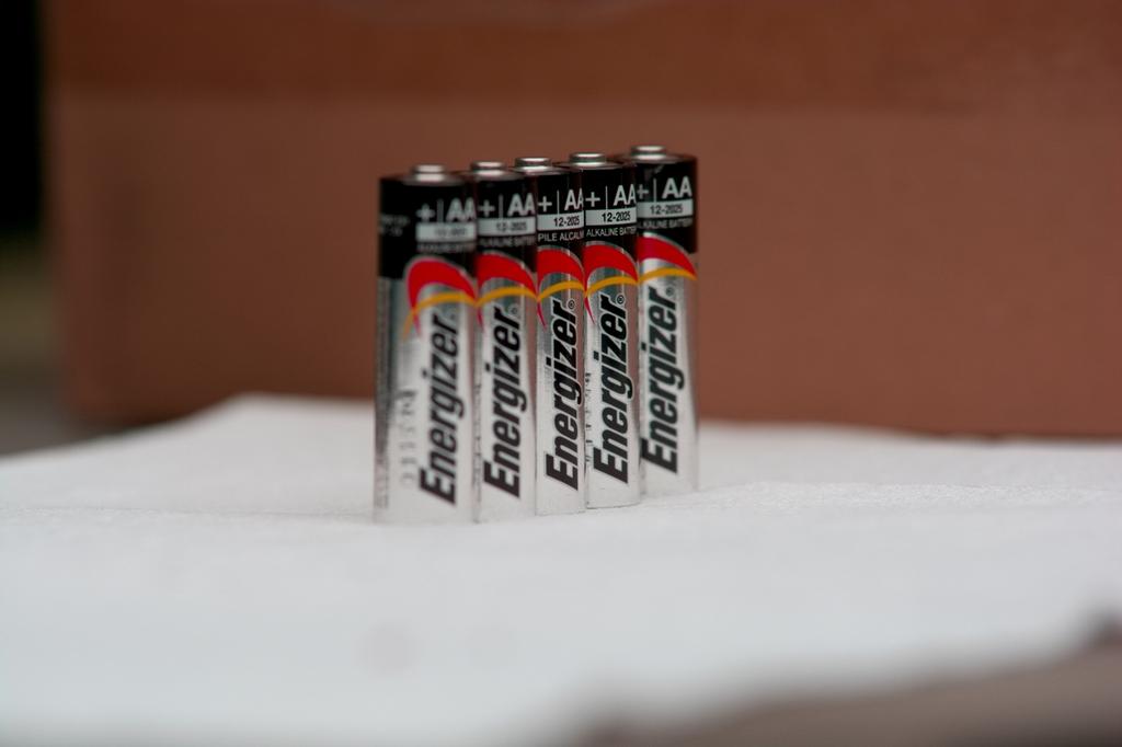

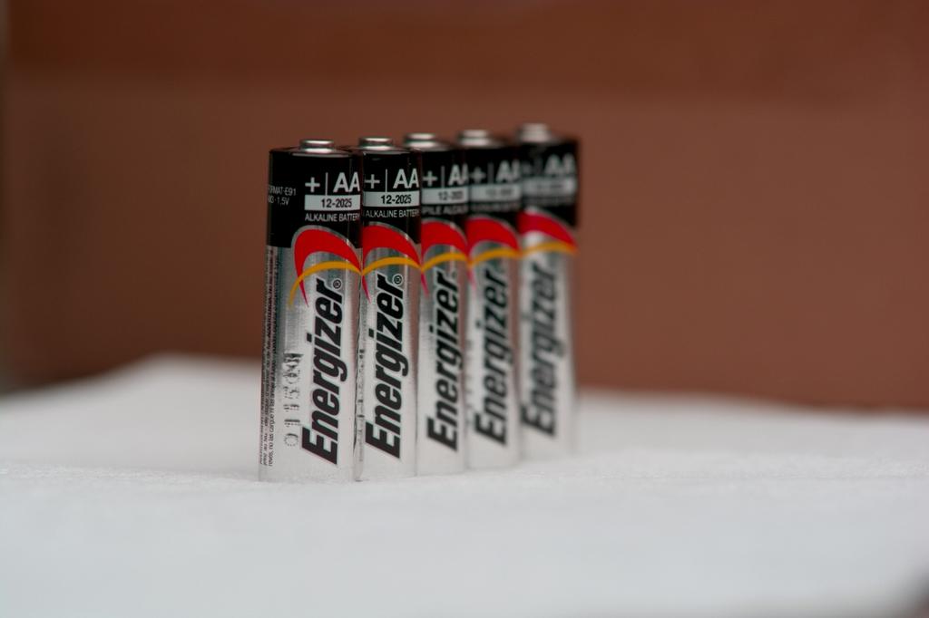

Thanks......Here is -5.
Yeah, absolutely no sharpening or adjustments.

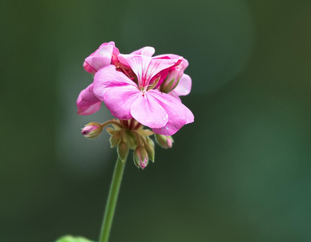

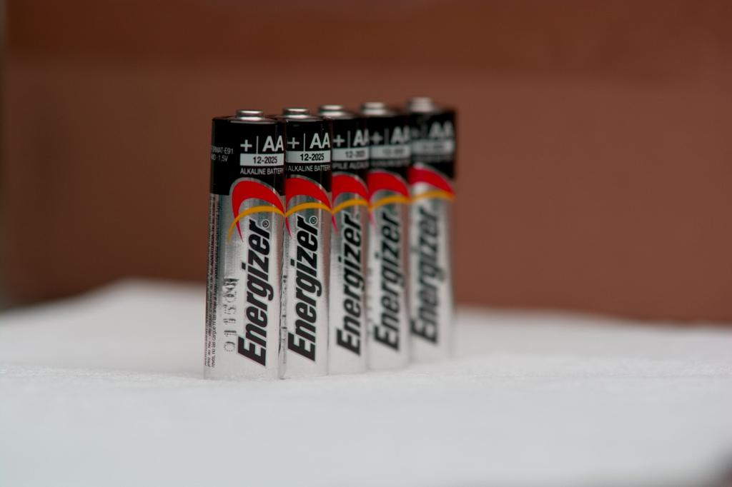

How we looking?
If this is all I have to do......I can probably handle it. LOL.
Yeah, absolutely no sharpening or adjustments. ... How we looking? If this is all I have to do... I can probably handle it. LOL.
Thanks. (I'd still like to know what made things go off) :p
I think those images are looking quite good. The final decision has to be yours of course since I'm looking at significantly reduced images, but clearly you have the process nailed down. The rest is details.
