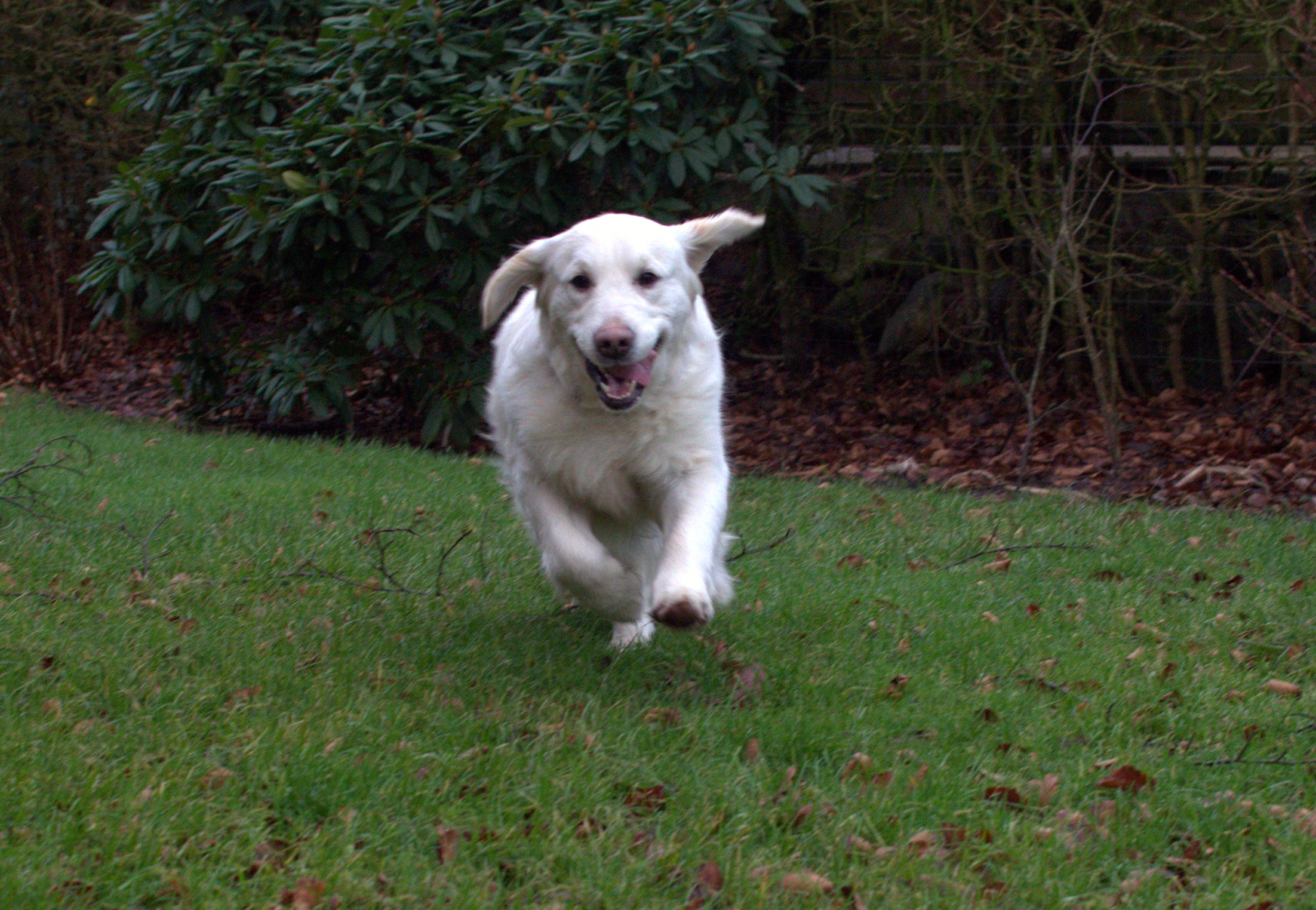

I'm still struggling a bit with my d7k. The camera works fine, no backfocus etc. But i often get less than sharp images, especially of moving objects. I'm guessing it's because of the focus settings.
I have the camera in AF-A and 3d focus. The reason for using 3D is that i want the focus to lock on something(face usually), and then keep that focus even if the person, or animal, moves around.
It seems like the camera struggles to do this, with my current settings. How do you setup up your cameras to accomplish this? IE half-press the shutter to lock the focus point on a face, and then either the person moves, or i recompose to get a shot of the entire person.
I'm fairly sure the problem lies in these settings, not in shutter speed, aperture or iso. I attached an example of a very un-sharp images. D7K_4187.NEF.jpg

Try AF-C, 9 or 11 point AF. Smaller aperture lenses are also slow to focus so try other lenses and practice a lot. Running dogs are pretty hard to capture unless you prefocus and set it to f8 to give you more DOF and increase your shutter speed above 1/640.

If you have not already, you can set your camera to display the focus point used when you play back the images in camera. This is very helpful as you experiment with various AF settings. You can also see this info using the Nikon software on your computer after you download the images. I suspect that in this case, the focus point is on the dog, but since he was coming right at you, the camera did not respond to that.
I'm still sketchy on 3d mode and have not played with it enough. AF-C might respond better. Set focus menu item a3 to 'off'. Menu a3 introduces a delay into continuous focus. Menu a1 will determine if the shutter will release regardless of focus in AF-C. I would try release priority if you find you can't get the shot with focus priority.
You could try short a burst of shots too with a1 set to release and a3 off and see if you catch a better focus.
