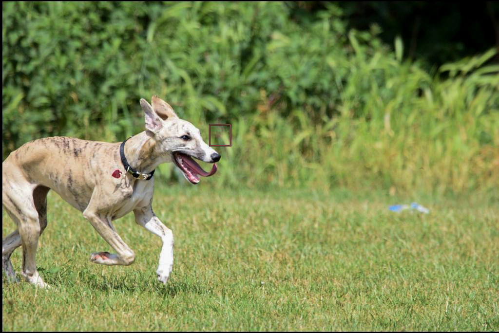

today i decided to try the 150-600 on the monopod for a bit of stability.
the red square is where the camera has chosen to apparently focus according to Capture NX-D???
shot at F8, 1/640, ISO400 image is just a screen shot as not one today was on point or focusing where the camera was apparently pointing - even on a massive great object like a church cross which was pointed at with the red square in the centre , told me it had focused on the main spire to its right lol , i gave up and came home, starting to thing the D5300 doesn't like the sigma 150-600c lol

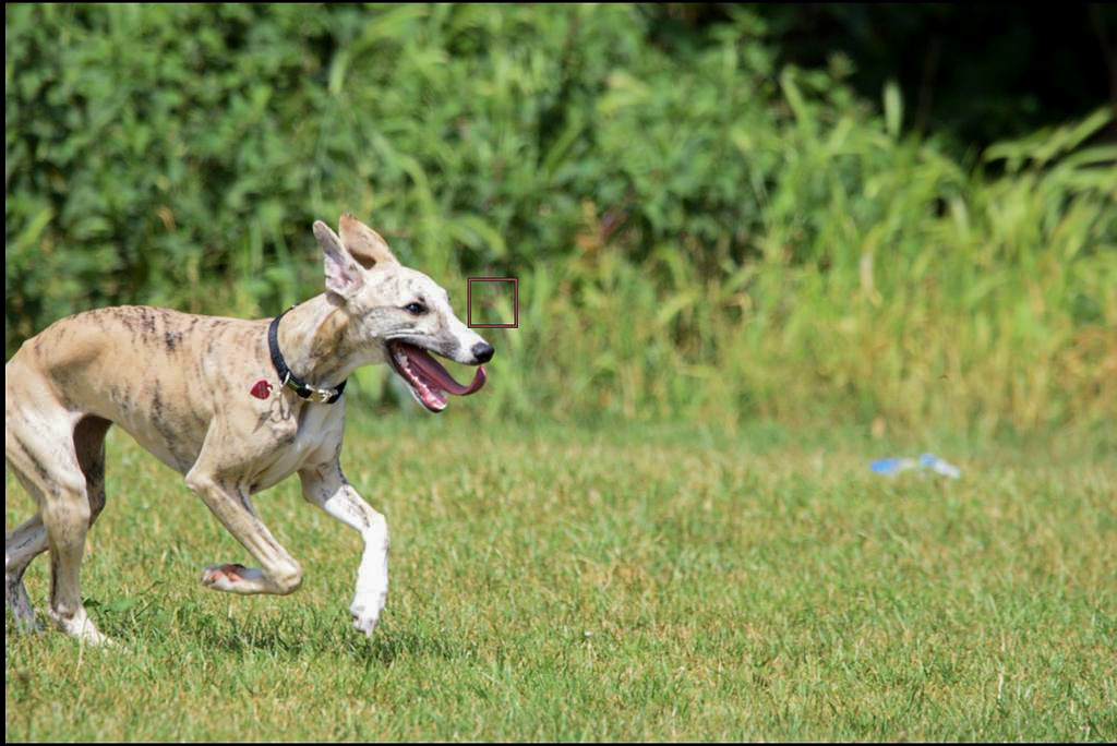

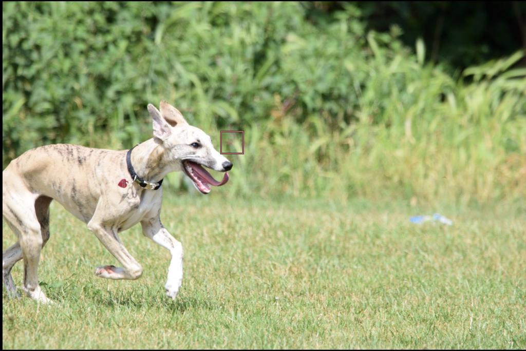

I have a feeling the D5300 needs f5.6 to be within spec for focusing, then it would only be the center focus point,that looks like its near but not the center point.
As nothing is sharp i do still wonder about camera movement, had a play with it to try and find the sharpest point it looks like the rear of the dog.
to me it looks like its the grass under the dog :( , the lens is F6.3 at 600mm where this was shot i moved it to F8, cant wait to get the D500 fingers crossed i won't have the same issues as you can set the lens :)

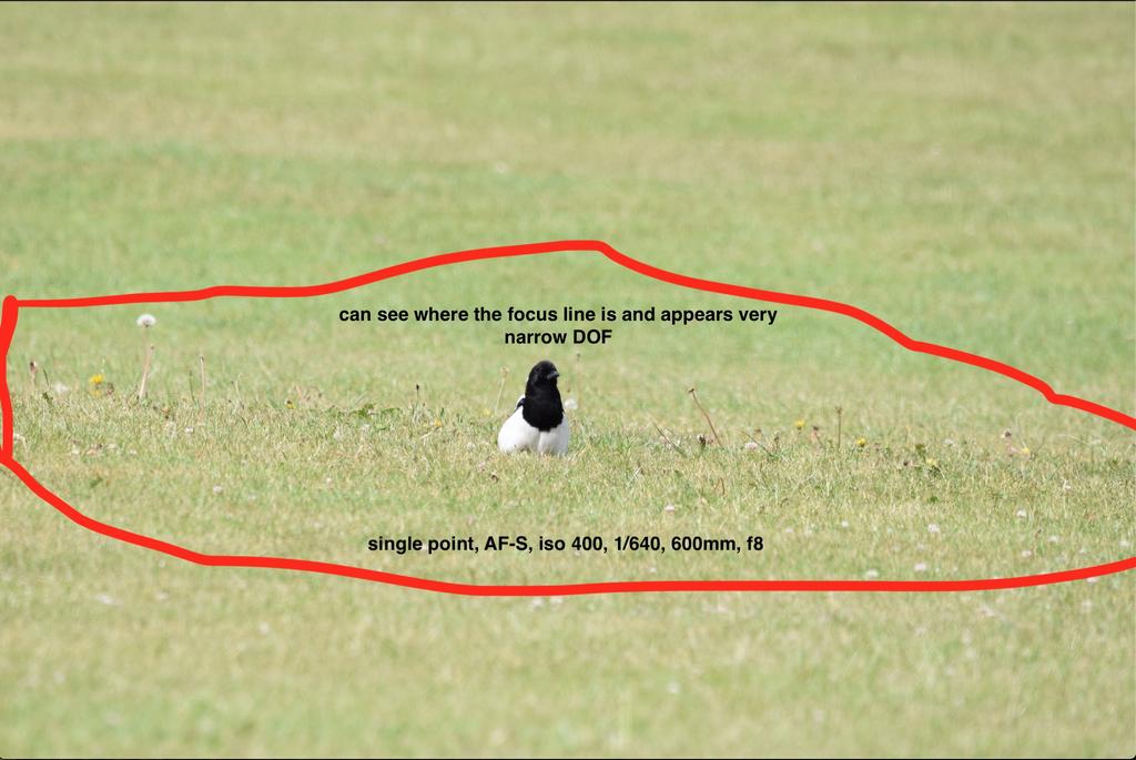

very narrow DOF and you can visibly see the area for focus from side to side ?

Yes. This what is expected at F8 and 600mm at that distance. You need to be closer to your subject for the whole image (grass and subject) to be in focus. To me it look like your are just a tad front focusing. That is to say in focus area in front of the image is larger than behind. But not bad.
every time i got closer they flew away LOL

Don't know if anyone has mentioned some lenses are not their sharpest at the max reach. My 70-300 is sharper at 270mm than 300mm.

single point and AF-S on the magpie, and 39point on the dog
I would have used a single point on the dog AF-C, in fact i used it for most things, its expecting a lot to think the camera knows were you want focus.
I'm with Mike on using AF-C. But your problem was using 39 points. The camera didn't know which points were on top of the dog and which ones were part of the background.

I can't pan worth a darn. I have similar issues when trying to use large group focus points on crowded backgrounds. I have no idea what happened with your church, though. I read there are some issues with the software not showing the correct focus point, but I don't know under what circumstances this happens.
Hobbit
Is it possible the software has a glitch that does not show the actual focus point used? Does the focus point show in camera as the same one?
no the one in the camera is dead centre where i put it, unlike capture NX-D which seems to put it where it thinks was shot on a monopod with centre point on the eyes / heads via the viewfinder. i will be sending it off to Nikon or a service centre shortly once my new one arrives :)
On the dog is it AF-S or AF-C? If it's AF-S on a moving subject that's your problem. If AF-C, then your original focus point was likely not on the dog. Of course, the focus system isn't perfect and will make mistakes once in a while, as well.

Woodyg3
Cindy, using dynamic focusing(39 point in this case) if the original focus lock was on the dog, the camera will track that spot on the dog as long as it stays within the 39 point grid. It won't look for other spots.
Woody, the way I understand it, if the contrast and overall tone of where the point was placed is very similar to the surroundings, the camera can't tell the difference. If the background is overly bright or dark, then it is easier for the camera to stay on the subject. At least that is how I've understood the concept when more than one point is used. Maybe I'm wrong though....:confused:
