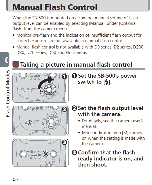

The problem though is this: Page C-3 of the SB-500 manual describes Manual mode (which the RF-603 requires), and says this:
It says a few times: On the camera, uses the camera menu. On those Nikon camera models that were designed to work with such a menu-less flash.
