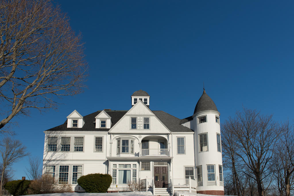

The more I learn the more I need to learn. I've just discovered the polarizer filter. I took my 1st shots with one on my 24-70 lens.

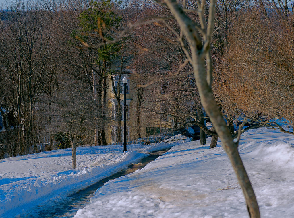

Eyelight
Does not look like a WB issue. Shadows appear blueish on snow at times. The recent shots I have of blue Kentucky snow are early morning light and come to think of it, the sun was at 90°, which is what the light appears in #2. I'm guessing the polarizer enhanced the blue. Would be interesting to know any post processing.
J-see
It's possible the CP has something to do with it and it saturated a "natural" blue cast.
I was goofing around with some of my snow shots a while ago and at some point ended up with blue snow too, at least the shadow parts, so maybe it is post.
Horoscope Fish
Doesn't look like a WB issue to me either; there are "clean" whites in the shot if nothing else, even if some areas are unnaturally blue. My guess is that VERY CLEAR blue sky we see in the first shot caused the typical blue color-cast you get on a clear day to begin with. The white snow reflected that blueish light and the polarizing filter simply enhanced it. Anything done in post (e.g. Saturation or Vibrance) would enhance the color cast where it's the strongest to begin with even further.

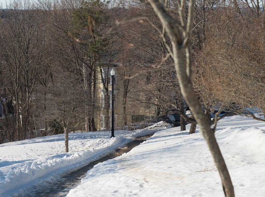

Yes it is a post proc flaw.....I was just messing around and got the blue snow...Here is the photo with no proc...btw..the polarizer is a Hoya HD-CIR-PL 77mm.
