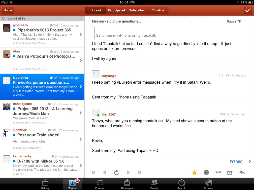

Krs_2007
Tonya, what are you running tapatalk on. My ipad shows a search button at the bottom and works fine. My iPhone shows the same. As the below from my ipad
Kevin,
Sent from my iPad using Tapatalk HD
