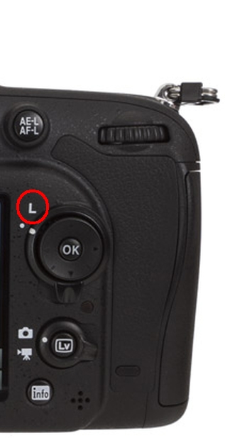

This has happened to me countless times... Make sure the focus lock switch is not in the "L" or "Locked" position; you want that switch aligned with the white dot like you see in the picture. This switch is ridiculously easy to flip accidentally.
