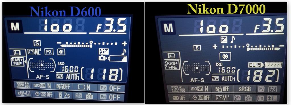

For some reason my cameras are reading different exposures with the same settings.

Lawrence
Looks the same to me.
On the D600 you have the minus going left whereas on the D7000 the minus is to the right.
or am i missing something?
MrVee
Your right! But my question is why is the exposure negative on one an positive on the other with the same lens mounted. ISO-1600 F-stop 3.5 Shutter 100 Exposure 0.0.

MrVee
I feel so dumb, I never even looked. Your a genius. Assuming negative is on the left side. I have rocks for brains. Thanks for replies.
Why is a great question that only Nikon could answer. Same thing with the + and - buttons in the back that have been switched. But, you know that you could reverse the +&- in the viewfinder. I don't exactly remember the menu number, but if you look under the menu (f-9) you can reverse the indicator on the 7000.

BackdoorArts
One thing to be aware of, depending on the metering mode, the larger view available to the FX sensor could result in a different meter reading. For spot metering they should be the same.
