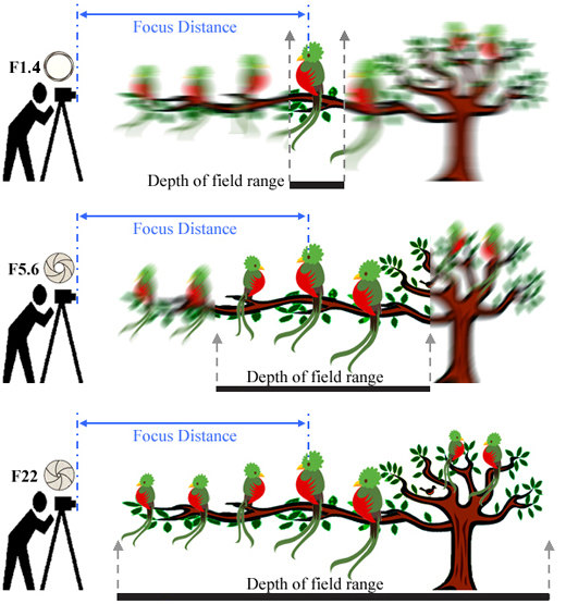

The answer is the same as before: depth of field limits. In addition, the obstruction is likely lighted unevenly, or has different shading, from near to far. (Possibly a piece of weatherstripping?) In addition, the far portion, that nearest the cat, is closer to being in focus than the rest of the obstruction, which is closer to the camera sensor.
