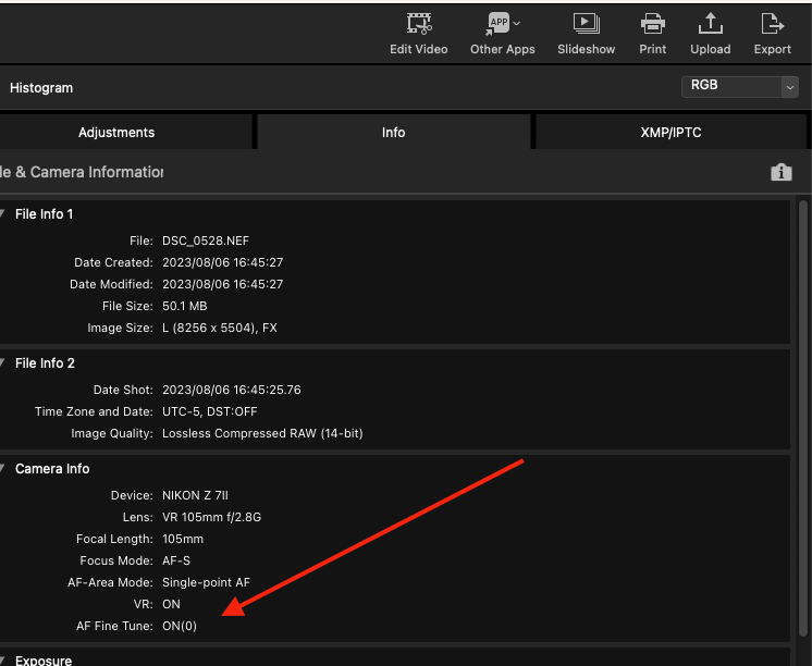

That's a specialized value unique to Nikon and probably only their software is going to read it. Using Nikon's NX Studio, you can see the value. Interestingly, they don't list it the XMP/IPTC panel but in the INFO panel under camera info...
Here's a screen shot of the right-hand portion of NX Studio... It shows whether AF Fine Tune is Ob/Off and its value. There are a few conversations on a Github subforum discussing how to extract the data with specialized software (think write your own) but I don't think that's what you want.
