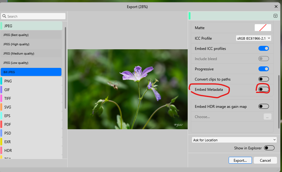

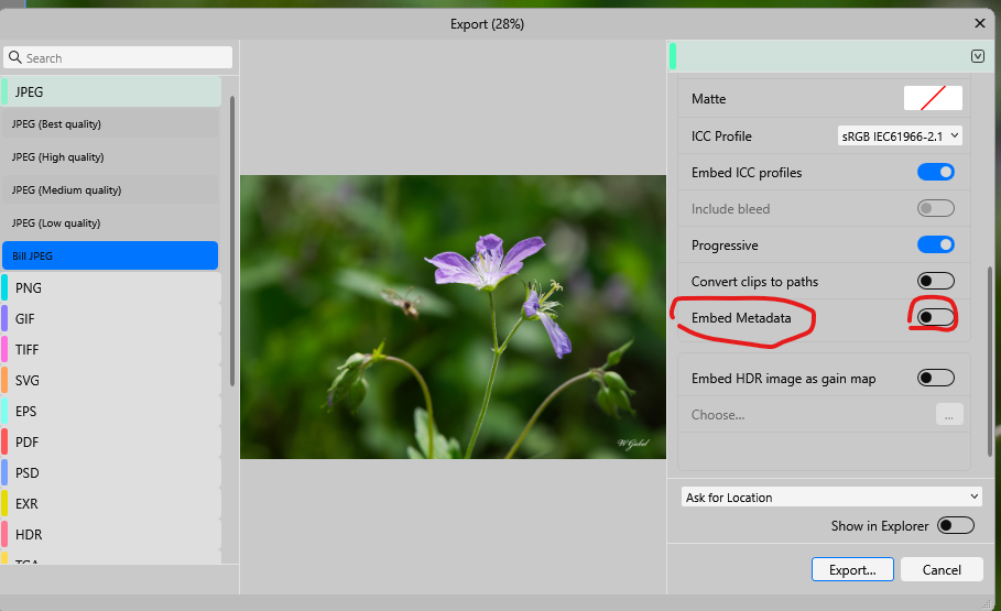

I use Affinity V3 when exporting a photo turning this off (see screen shot below) everything is gone.

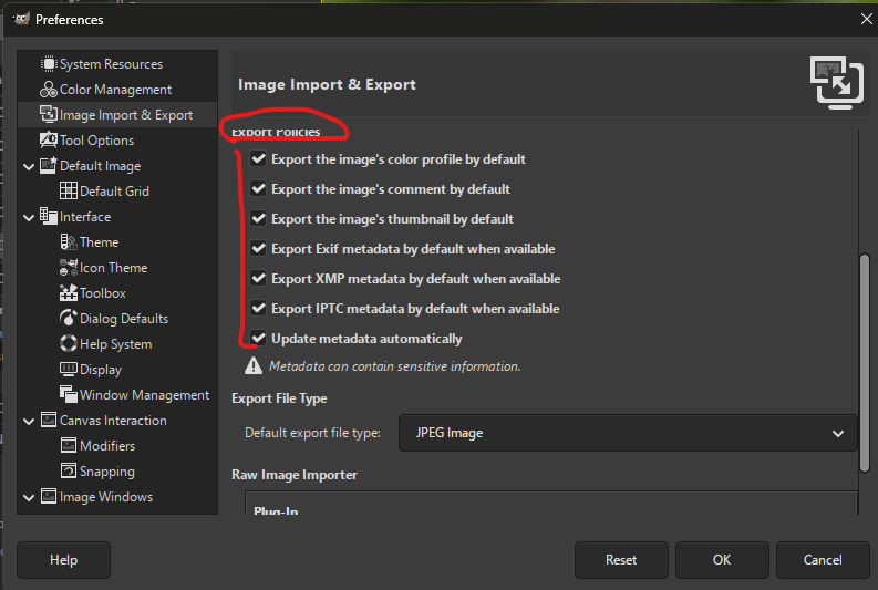

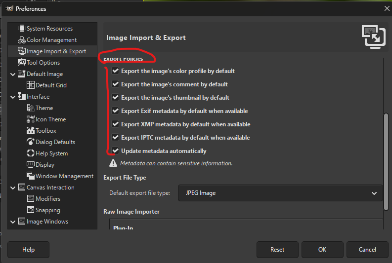

In Gimp there are more options you may have to select to get what you want
BTW Affinity V3 by Canva is a free program and is an Australian company

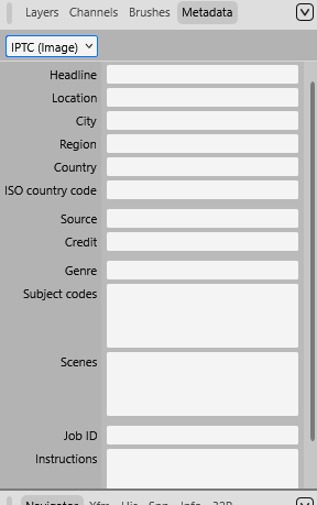

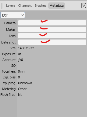

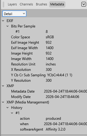

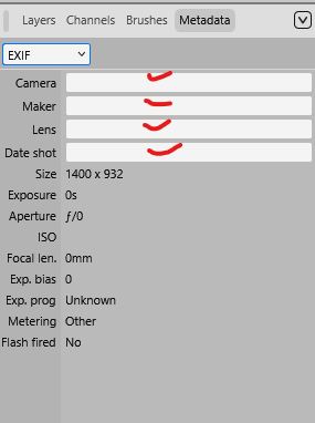

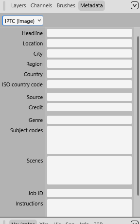

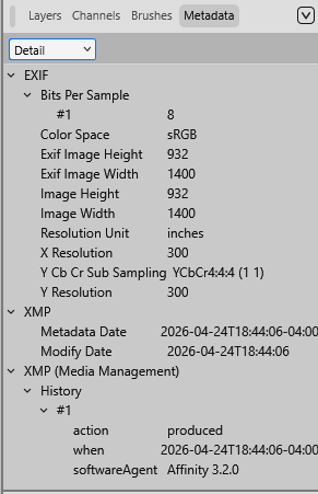

Well here are some screen shots of Affinity of what I can see you "can" change to see if it meets what you want. It looks as though one could add info to the white boxes even if the data had been previously striped. I will snip the different screens of a stripped photo for you.
In the examples above all white boxes can be typed in and saved. In the Detail screen nothing can be changed on that screen. The only screen I did not show is "raw data" it contains computer code pointers, I am not a coder so I cannot say how these could be interpreted by others. In my limited knowledge they are just pointers, but I cannot say for sure.
I hope this helps you
View attachment 427923 View attachment 427925View attachment 427924
View attachment 427926View attachment 427927View attachment 427928
