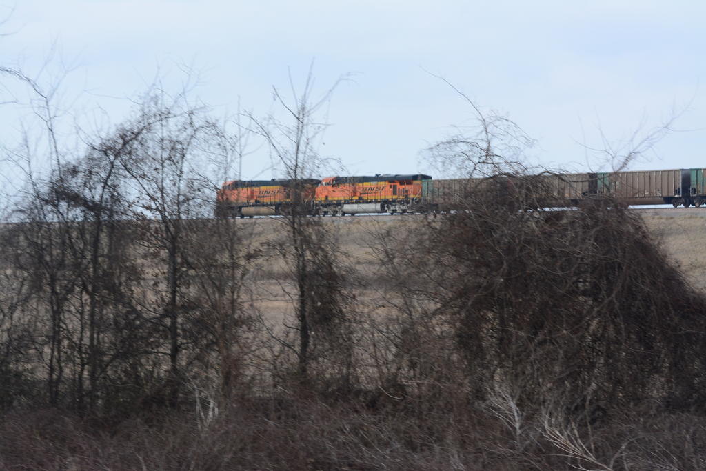

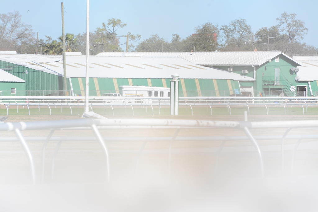

donaldjledet
EV said +3.0@[URL="http://nikonites.com/member.php?u=8330"]PapaST[/URL] DSC_0017.jpgon the train shot the sky is not showing any blue.EV showed +1.0
PapaST
That's pretty weird. From those settings I would think the green building pic would be under exposed. I can't think of why it's doing that. Perhaps a call to Nikon?
