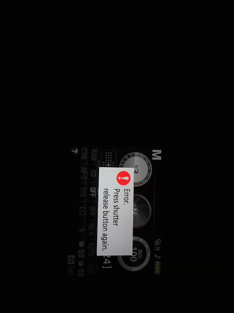

Error press shutter releases button again
<blockquote data-quote="480sparky" data-source="post: 657556" data-attributes="member: 15805"><p>Hate to tell you, but you've had a serious mechanical malfunction. Sounds like the mirror is locked up and the shutter is jammed.</p><p></p><p>Remove the lens and look inside. If the mirror is stuck up, you might be able to gently pry on it and see if it will drop back down. If it does, you MIGHT be lucky and it's a fluke. But usually, it means your camera has gone to it's great reward.</p></blockquote><p></p>
[QUOTE="480sparky, post: 657556, member: 15805"] Hate to tell you, but you've had a serious mechanical malfunction. Sounds like the mirror is locked up and the shutter is jammed. Remove the lens and look inside. If the mirror is stuck up, you might be able to gently pry on it and see if it will drop back down. If it does, you MIGHT be lucky and it's a fluke. But usually, it means your camera has gone to it's great reward. [/QUOTE]
