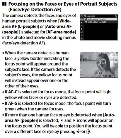

Blackstar - Looking at the Z6-II manual it shows there are three wide area large modes -- Wide area large - wide area large people - and wide area large animals. If people or animals were selected I suspect the processor was trying to find focus on the eyes (thinking there were eyes behind the glasses). Do you recall seeing any arrows beside the focus points?

Thanks, Bill. I set "wide area large" while the "double" focusing happened. It was not a "double-line square", but two big "single-line rectangulars" that were partially overlayed (not completely separated). Now from the page of the manual you showed, I seem to remember there were left and right arrows I saw in EVF. So that's the way to select which area to focus! But the question still remains how do you focus on two objects (areas) which are supposed at the same plane? Well, I guess the assumption of two objects situating at the same plane is probably faulty...

If my understanding is correct, those arrows you saw indicate you can "select" the square you want to focus on with your left or right arrow control. It seems the idea is to allow the photographer to choose what "eye" they want sharp. In a normal people shooting scenario this would work fine. I think the camera just saw two "eyes" and wanted to know witch one you wanted sharp.

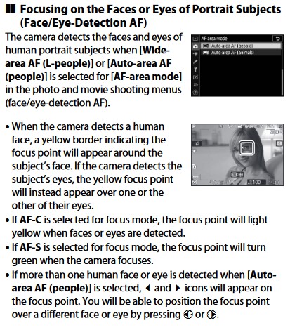

Your shot turned out great, I think you executed what you wanted to see very well (based on your description). I love the "pin point" focus for a shot like you were doing with the Z series system. Stacking is likely best to get very sharp detail.
Bill, This is still unclear now without experimenting all the scenarios out. In the Manual page you showed, it doesn't indicate any "double focus areas (rectangles or squares)", but I did see two (partially) separate focus rectangles.
My thought: if select "Auto-area AF (people)", there will be one focus point (square) on one eye which is determined by the camera. However, if there is another eye or person appear in the scene, it will give arrows for other selection by the photographer and the focus point will move to the new selection.
If select "Wide-area Large (people)" or "Wide-area Large", Since camera does not decide which focus point or area, but does the photographer, it will show multi-focus points (areas) if there are multi-objects (eyes, persons, etc.) in the scene and arrows for focus point selection by the photographer. Too bad I didn't think of this when double-focus areas present in EVF and didn't try the arrows to select a focus area, but puzzled and shocked by double-vision!
