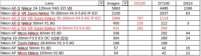

Here is my historic lens usage.
Note D5100 info only since use of current program and shot in RAW. The red represents equipment no longer available. Also the 70-300 currently lives on the D7100 other than some testing .
So the simple answer it replace with another 24- 120 F4. It’s inexpensive and would be familiar. Any thing I’m missing here?

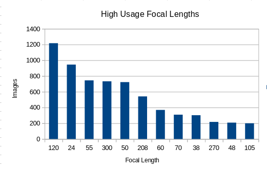

No surprise 24, 120 and 300. 208?
