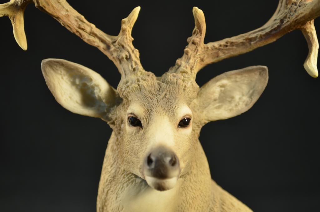

I've been experimenting and getting better with close-up product shots using the Nikon D5100's 18-55mm AF-S kit lens, but I'm still a bit baffled when it comes to getting better depth of field. For example, though I've messed with aperture settings in the M mode, I'm still not getting the depth I want when doing close-ups of figurines, etc.
In this photo a distance of only 1 inch from the deer's eyes to his nose yields a blurred nose when I had manually focused on the eyes. I realize this isn't a major issue, but the better the overall focus the better for sales, I believe. Is it a settings issue? Is it a lens issue? Is it just normal? Any ideas?
Thanks!

Regarding the pic you posted, there is nothing wrong with it.
Since you focused on the eyes, the nose is going to be blurred.
Think of where the eyes are as a sheet of paper & keep placing more sheets till you reach the nose.
Lots of sheets of paper in between eh?
That shows each of them are in different focus planes, hence the blurry nose & clear eyes

So, are you saying that the amount of blur on the nose is to be expected even with careful aperture setting adjustment? To be precise, I was at a distance of about 12 inches from the 18-55 lens to the figurine.

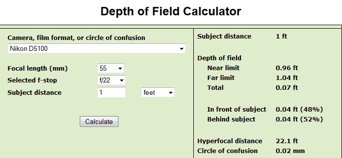

Also remember that you are not going to be able to get everything in focus when the object is small and you are close to it. If you shoot F22 and you are at the limit for the 18-55 55MM you can focus at about 1 foot. You can see here that you do not have much room at best
As you can see only .07th of a foot will be in focus.
You can see this calculator at Online Depth of Field Calculator
Yes, it is to be expected definitely.
Shoot the same subject at the same distance, with varying apertures - f9, f11 and f22..
You will find the nose getting clearer & clearest at at f22.
Also if you move away from the subject, the DOF won't be as shallow as when you are upclose.
Try both of the above out, you'll understand better.

Go to Online Depth of Field Calculator and play with the different numbers. That will show you how distance, Aperture and focal length can change the DOF you are getting. Play with only one at the time and watch the numbers. Greater distance and lower Aperture can give you the same DOF as less distance and larger Aperture. Then we get into perspective which is what makes your nose look really big when someone puts a camera right in your face and shoots.
