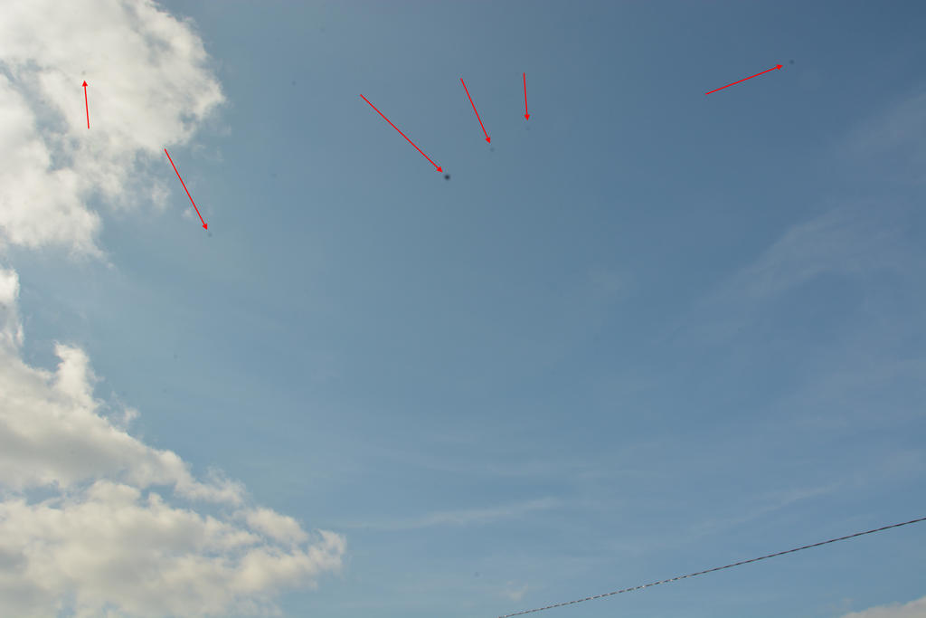

Hi, I'm having a strange problem with my Nikon D7100.
There is a dark speck near the centre of the image. I've cleaned the mirror and the sensor, but the speck remains.
I have three different lenses and the speck shows in the exact same spot with all of them, so it's definitely not a lens problem. Also, when I take a picture without a lens attached, there is no speck.
Does anyone know what may be causing this?

Need to see an image or two. Could be a dead pixel. Could be dirt. Have you used a loupe or magnifier to really look at the sensor? Either way, post a couple images.

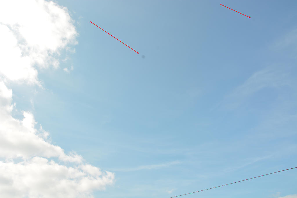

I'll try to attach some images. The spec is actually most prominent at smallest aperture, so it seems the mirror or the sensor are still dirty. At F3.5 you can barely see it and it's larger, while at F22 it's small and very visible along with a few other specs. I'll have to do a better cleaning job I suppose.

It's on your sensor. If it was on your mirror, then you would see it in the viewfinder, but it would not show up in the images. And yes, contamination on the sensor shows up better, the smaller the aperture you use.

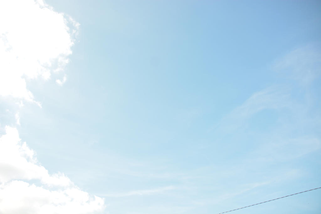

Attempting to attach sample images again (f/3.5, f/11, f/22):

It's not on the mirror. The mirror only affects the view through your viewfinder, and not what actually gets recorded as an image. When you take a picture, the mirror flips up out of the way, allowing light from the lens to get directly to the sensor. Your mirror could be so filthy or so damaged that you can't even see through the viewfinder, and it still wouldn't affect the picture that gets recorded.

Yes, you've definitely got some dirt on your sensor. If compressed air doesn't do the trick, the next thing to try is this brush; buy it, read the instructions carefully, and follow them. If that doesn't do it, then you need to get a wet-cleaning kit, such as this one.
It is one of the unfortunate facts of life about DSLRs (probably equally with MILC/EVIL cameras as well) that dirt does eventually get on the sensor, and you need to know how to clean it and be equipped to do so.

Attempting to attach sample images again…
By the way, here's how best to take an image that will show up the dust on your sensor…
  1. You've got the 18-55mm “kit lens” that is standard with this camera, right? Mount that lens.
  2. Set the autofucuts switch on the lens to “M”, and manually focus it to infinity
  3. Set the zoom to its longest focal length, 55mm.
  4. Set your camera to aperture-priority mode.
  5. Set the aperture to its largest number (smallest aperture) which will be ƒ36 with this lens.
  6. Set your camera's ISO setting to its lowest value.
  7. Bring up a browser or some other application on your computer's screen with a blank page/document, so that you just have a big expanse of plain white on your screen.
  8. Holding the camera an inch or two away from the screen, take a picture. Move the camera around a bit during the several seconds of the exposure.
The idea here is to not really take a picture of anything outside of the camera, but to evenly and narrowly illuminate the sensor, record what the sensor is seeing. The point of using the smallest possible aperture is to provide the narrowest possible light source. A narrower light source makes for sharper shadows, which is why, in the pictures you've taken so far, the dirt shows up more prominently the smaller the aperture you use.
If your sensor was perfectly clean, and perfectly free of any noise, any unevenness, or any other possible imperfections, then you would just get a picture that contained nothing but the same uniform solid shade of grey. Nobody's sensor is that perfect. If there is any dust, dirt, or foreign material on your sensor, then that is what will show up most prominently.
