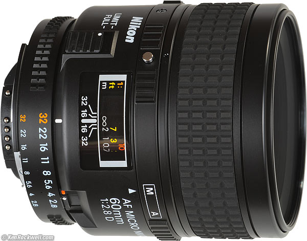

It's this lens:
Marcel
Happily retired
It's this lens:
Aperture should be changed with the front wheel (sub-command). If it doesn't, something is wrong. Maybe cleaning the lens contacts would help, if not, time for a visit to a Nikon service center I guess. I hope you find a better solution than the repair center. If you have a friend with a Nikon, just test the lens on another body to make sure it's the lens. Does the camera work well with other lenses?
