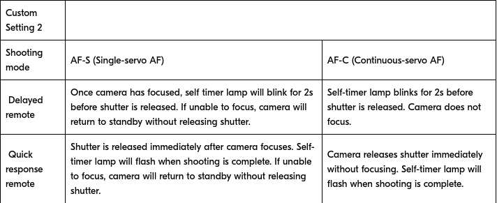

D750 set to manual focus mode & using remote ML-L3 won't fire because the camera does not show ⦁
<blockquote data-quote="BF Hammer" data-source="post: 843535" data-attributes="member: 48483"><p>"Release" is the correct setting, but I think that is what you mean. It's what I was trying to remember in my earlier answer while on lunch break at work.</p><p></p><p>Then there is this in the footnotes for using the ML-L3 remote...</p><p>Page 195 of the D750 user manual:</p></blockquote><p></p>
[QUOTE="BF Hammer, post: 843535, member: 48483"] "Release" is the correct setting, but I think that is what you mean. It's what I was trying to remember in my earlier answer while on lunch break at work. Then there is this in the footnotes for using the ML-L3 remote... Page 195 of the D750 user manual: [/QUOTE]
