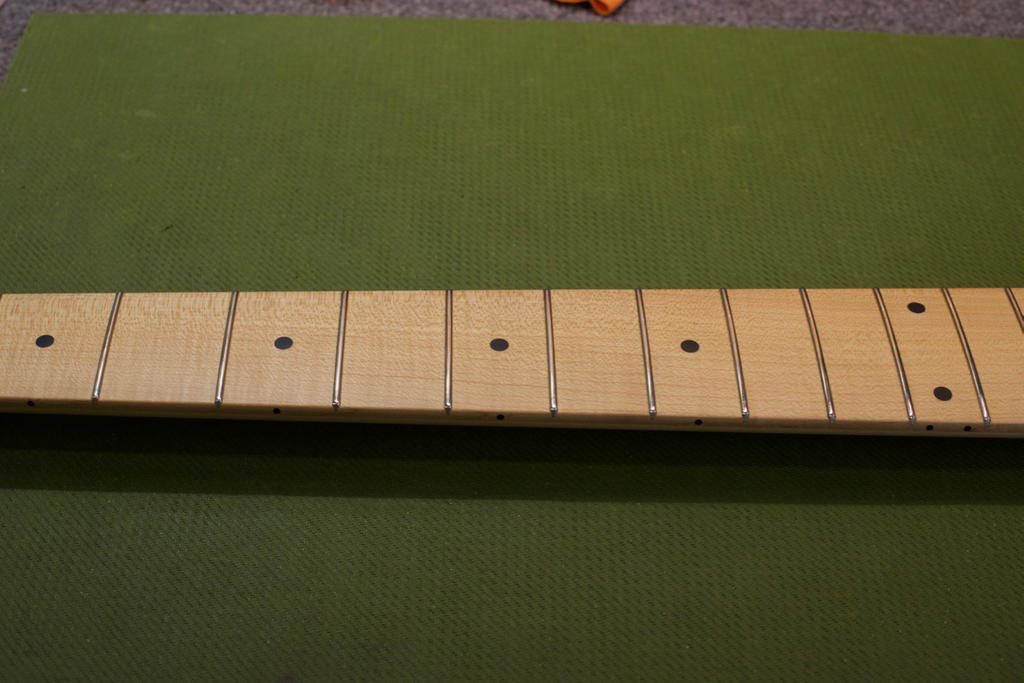

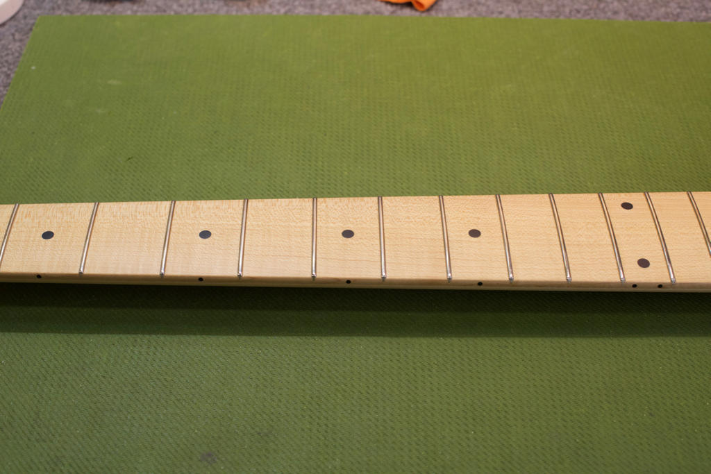

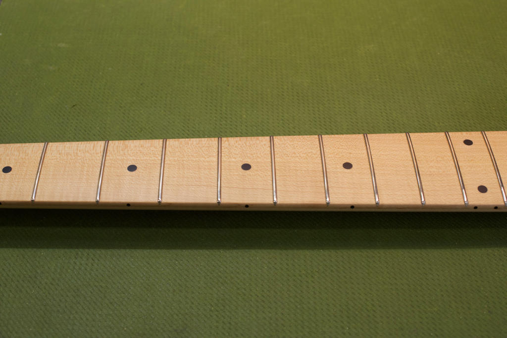

I am having exposure issues with my D750. I have a few months left on my warranty and would appreciate your advice if this is something I should send to Nikon for repair, or just adjust in the Menu setting.
When I shoot in either P, S or A modes.....I get the following results....from top to bottom...
Spot meter mode: 2 stops underexposed
Matrix meter mode: 1 stop underexposed
Center weighted mode: looks right to me.
Thanks for your advice and suggestions.
Roger

Based on those photos I don't think you have an exposure problem; all of those exposures look correct to me based on the metering mode you selected. The root of the problem, I think, is that you may not fully understand how your camera determines exposure.
This article explains it all in depth and better than I could: Camera Metering and Exposure
The quick fix for your situation is to simply correct the exposure during post-processing or use the Exposure Compensation function on your D750.

The camera looks fine to me and the results as expected. You need to familiarize yourself with the metering modes and the exposure meter. The matrix mode is kind of auto mode that gets the exposure close enough, and until you know how to get the maximum out of center or spot modes -- and why -- it's safest to use matrix.
Spot meter should only be used when you have exactly an 18% grey target. That is what it is set for. Matrix has its uses but rarely do I use it. I almost always use center weighted. Depending on the subject you might have to use exposure compensation.
