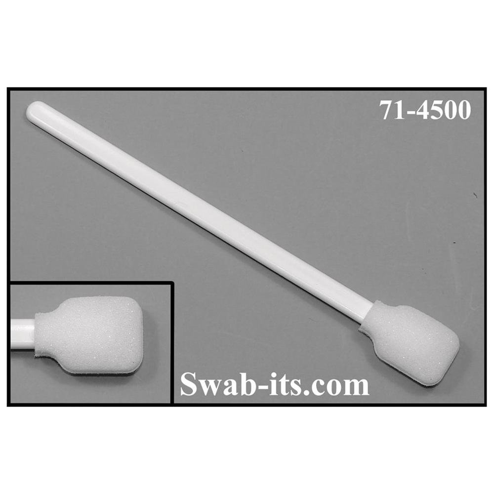

ummm...I'm curious...what did you clean the contacts with? Rubbing alcohol would be a good choice. There's also electrical contact cleaner which is very good. I use a Q-Tip to clean my contacts.

Not to get off subject here but Q-tips? really guys? Wet or dry the fibers can come off and get into your camera.
In my lab the only type of "Q-tip" we can use is the foam kind. Yeah still a risk of a piece of foam falling off, but not as much as a Cotton Swab fiber.
Just my 2 cents.
Here's a link of a photo of one I found on the Web
https://images.search.yahoo.com/ima...igi=13rhfmkdt&.crumb=uFSmM/x1Gur&fr=yfp-t-194
