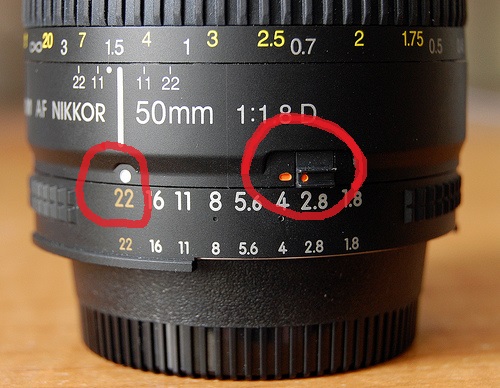

<blockquote data-quote="480sparky" data-source="post: 539921" data-attributes="member: 15805"><p>Just a technical note: You <strong>DO NOT</strong> need to <u>lock</u> the aperture ring. You only need to </p><p></p><p>Once the lens is at minimum aperture, everything will function as designed.</p><p></p><p></p><p></p><p></p><p>Locking the aperture ring only <em>prevents one from turning it away from minimum aperture</em>. <strong>That</strong> is what causes the FEE error. You can merrily shoot away with the lens unlocked.</p></blockquote><p></p>
