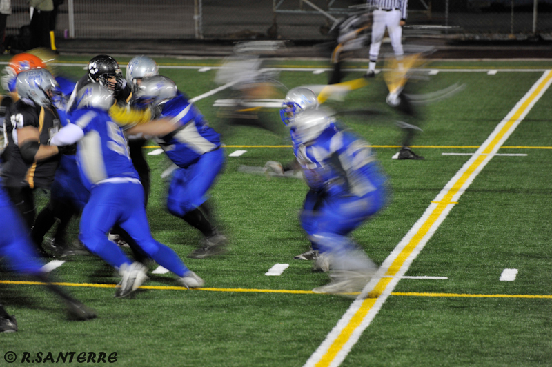

What about with a 70-300mm f/4.5-5.6. I tried as you can see, but failed miserably so i gave up after 5-6 shots. :-( Son was disappointed since they were finals.
I ended up with 1/13 s (argh), when shooting at 300mm, f/5.6 and 1250 ISO. What were my options, would boosting ISO to 2500 be enough to reach 1/250, or should i just stick to day games until i can buy a 2.8? :) Thanks
Joseph Bautsch
I have the 70-300mm lens. It's not going to give you the speed you need for night time football even with an ISO of 3200. With this lens I would stick to day time shooting of football games. An f/2.8 lens will give you a couple of stops more room to work with for night games and getting stop motion. A shutter speed of 1/250 is ideal for stop motion but you can also get decent stop motion using 1/125. It's not as good as 1/250 but it works. You might give some thought to using a 50mm, f/1.8 lens. It's not an expensive lens and at f/1.8 you should be able to shoot at 1/250 with a reasonable ISO level. Maybe not the telephoto you want but with a little patience and allowing the action to get closer you can get some really good shots.
