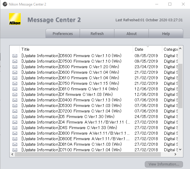

If you download and install either of the free Nikon applications, ViewNX-i and/or CaptureNX-D, Message Center will be installed as well. It's where you will find out about updated versions etc.. I have had a look for an earlier version for your camera and there does not appear to be one showing. However, someone on here may well have one saved that they could email to you.
