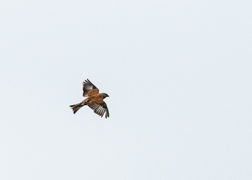

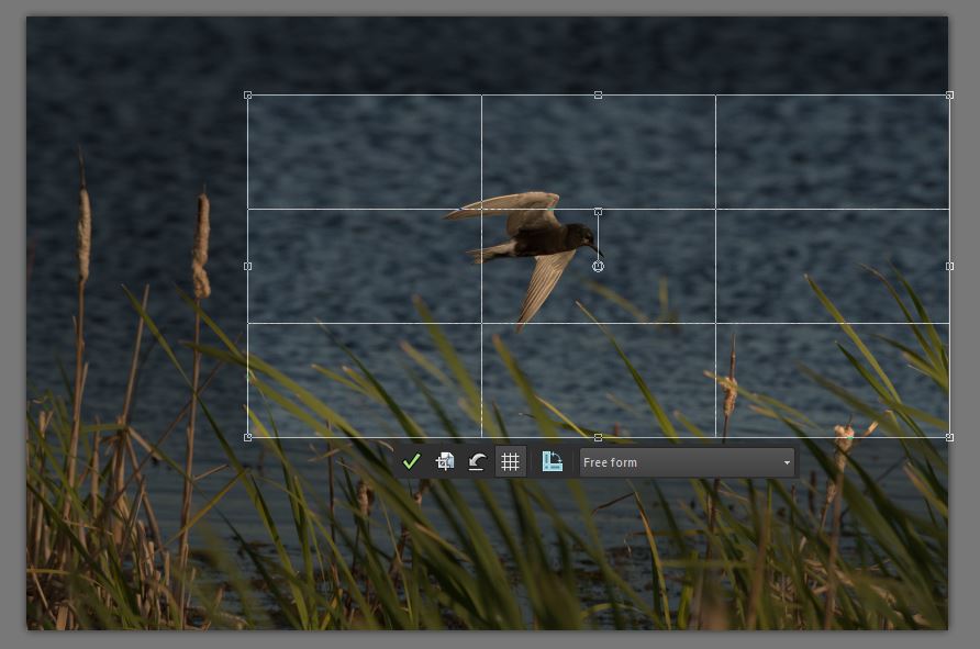

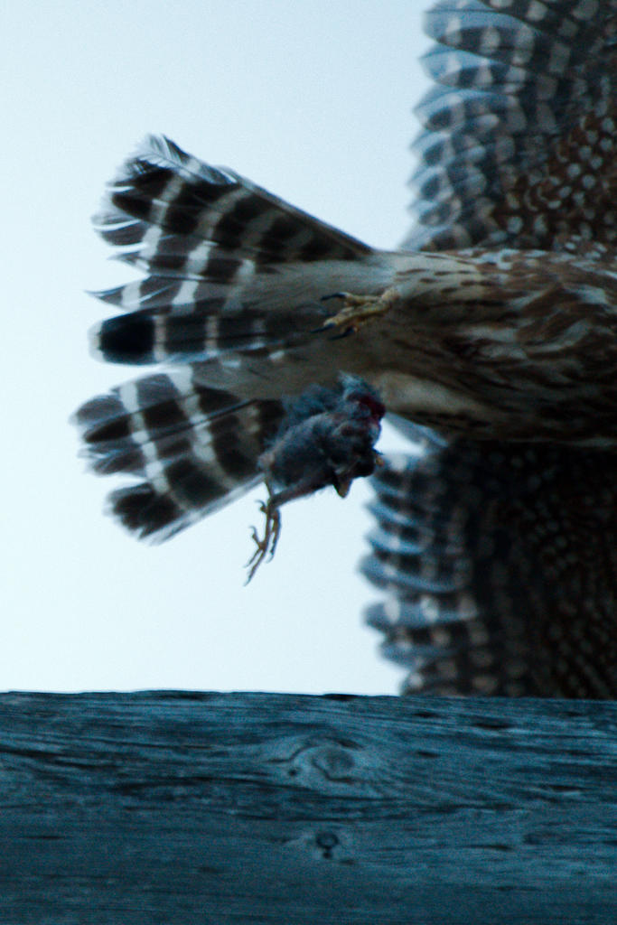

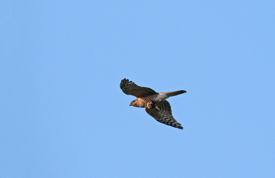

At the moment ime trying for small birds in flight Swallows ect I am getting them but as i only have 300mm at the moment they are too small to use,this is a Linnet @ 300mm,by the time its cropped its fallen to bits,this is a case where getting closer will not work :D
