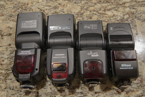

This picture says a lot, I don't want a big object sitting on top the camera at all really, so small size is very important.
So atm its looking like the Altura, which is cheap and comes with a bag and diffuser. EDIT: Can't seem to get them direct in the UK ! Might have to order one in ..
