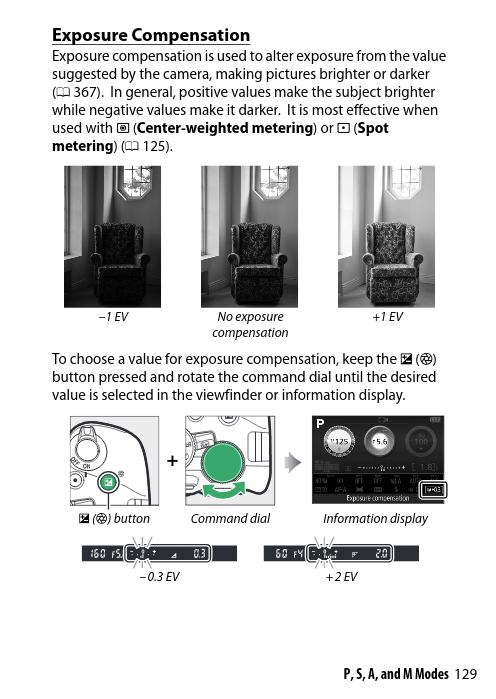

Thanks Brent. The entire picture appear to be much lighter than what I would expect them to be. How do I set the exposure compensation to zero?
Needa
Challenge Team
Re: Exposure Compensation
Exposure compensation is on page 129 of the reference manual.
Normally should be set to zero.
