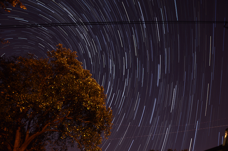

P.S. Attached photos show - A) 100 exposures@50 minutes.

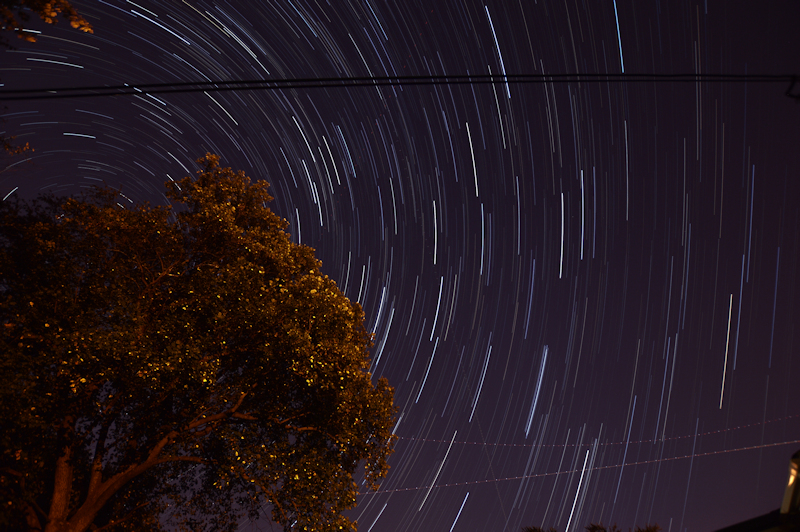

B) 200 exposures - 2 sets of 100 exposures with 40 minute gap.

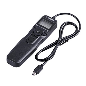

I purchased this programmable remote trigger. It was reasonably priced and has all the features one might need. Exposure time, delay, interval, etc. Now I just have to choose the right location, and wait for the optimum weather conditions.71qtcA6TtLL._SY355_.jpg
