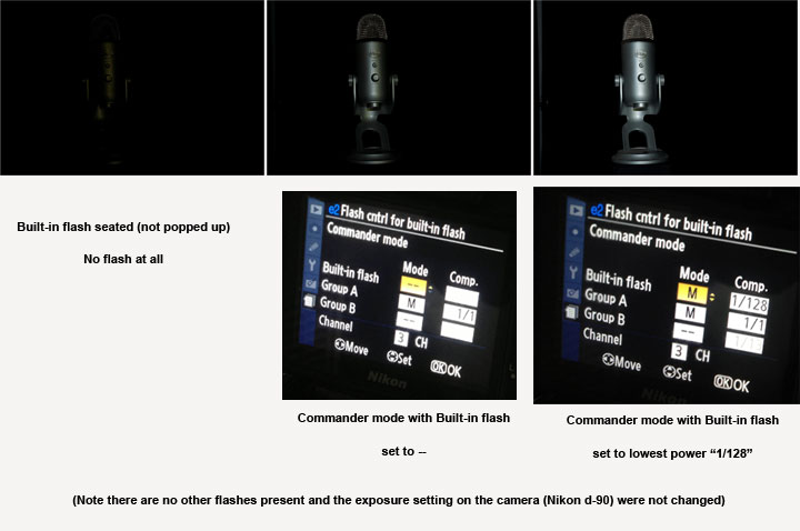

When I am using my Nikon D-90 in commander mode, with the built-in flash set to not be used (--) I still get some light from it in the final image.
I created the image below to illustrate what I am seeing. Note that there is no change in the exposure settings or the available light. And there are no other flashes present.
The first image is with no flash at all (built-in flash not popped up)
The 2nd image is in commander mode with the built in set to not be used (--)
The 3rd is in commander mode with the built-in set to it's lowest setting 1/128
Does anyone else get these results?
Is there any chance this is user error?

Wow! that's a bummer. I always assumed that the main flash was timed to occur after a pre-flash from the commander. That is a big blow to use usefulness of commander mode.
I really appreciate the info though. I spoke to a Nikon rep on the phone and he seemed to think the camera was malfunctioning and wanted me to send it in for repair.

Well frankly, objecting that 1/128 power interferes with your flash pictures sounds like your expectations might be too low. :) Just saying, if your remote flash needed to be up near 1/4 power or something, it would surely entirely cover this up.
Setting the mode to "--" does turn the internal flash off. Totally off, as a flash. However, it is also the Commander, so it will still flash commands BEFORE the shutter opens, but then it will not contribute to the picture lighting after the shutter opens.
Except, after shutter opens, it still has to flash a signal to the remotes "OK, Everybody flash NOW!". Your test result shows this is less bright than when you told it to contribute with 1/128 power, which added to it.
But... there is an optional $12 Nikon SG-3IR panel (placed in the hot shoe, and from there, it can cover the internal flash) which blocks the visible light from the flash, and still allows the infrared component (sufficient for the commands.) If you cannot use a brighter flash for your pictures, then that should help do the job.
See Using the Nikon CLS Remote Wireless Flash System for more about this slave trigger signal and the SG-3IR panel.

One of the biggest problems when using an on camera flash as commander is that you will not eliminate reflections. The images you show. The light is mostly reflections. Simply put you hand between the flash and the subject while still allowing the other flash to see it.

I was just looking at that little dodad. seems like a good fix. Thanks
Wow! yeah that is a simple (and should have been obvious) fix. Thanks

The camera communicates with the remote flash via pulses of very low power flashes - as sequence of "dot" and "dashes" like Morse code. That communication string tells the remote flash what settings to use - ie power level, head zoom position etc. Then when it's time to tell it to go off, it has to send another "GO signal" via another short burst of low level flash.
Now, the reason the pre-flash "setting" communications has to be different from the final "Go" signal is that it give you the option to "Flash Lock" ie, send the preflash separately to tell the remote flash to lock in the settings - then when you take the picture, it just need to send the "go" signal without being preceded by a pre-flash sequence. You can program one of the buttons to be the FV button -it's a good option especially when you are photographing subjects who are sensitive and quick blinkers - blinking at the preflash, caught with their eyes close when the main flash goes off. I always use the Flash Lock option when shooting models - just one pre-flash during setup and then shot away without any more pre-flashing. When you use Flash Lock, the locked settings stays until you do another flash lock so subsequent firing is just a much shorter firing signal rather than a longer string of pre-flash instructions.
