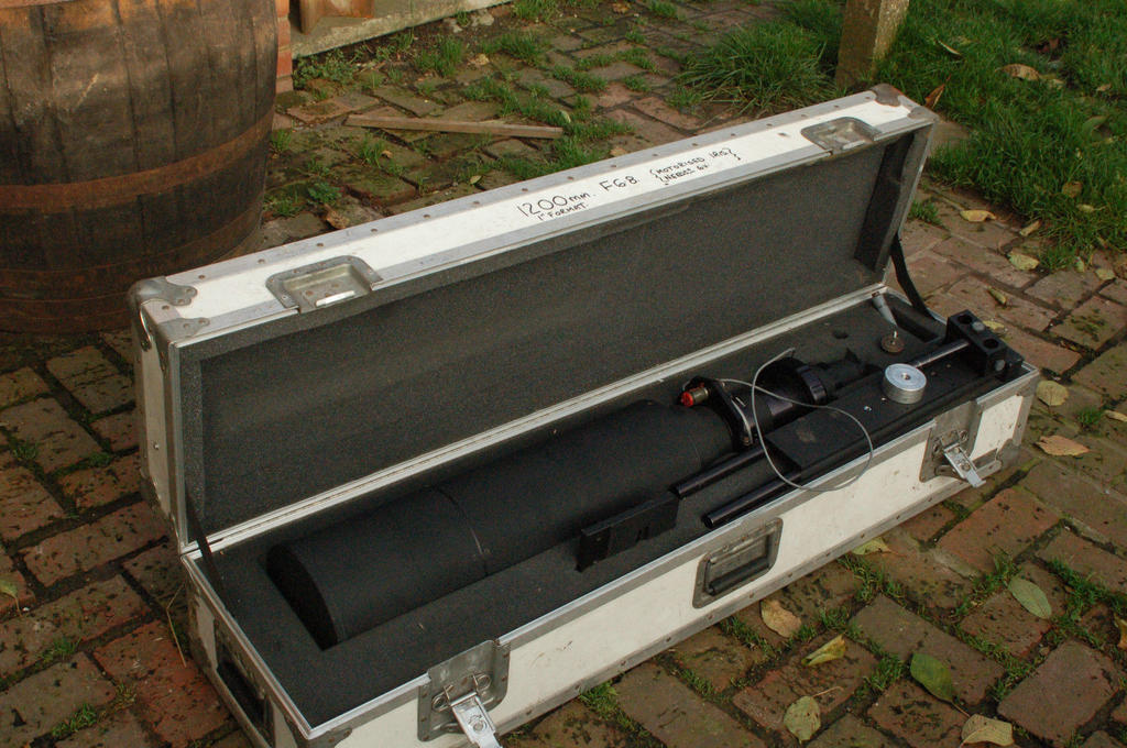

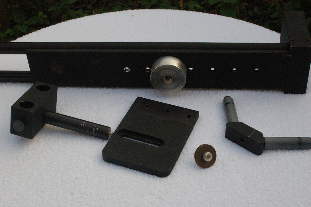

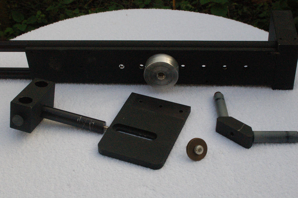

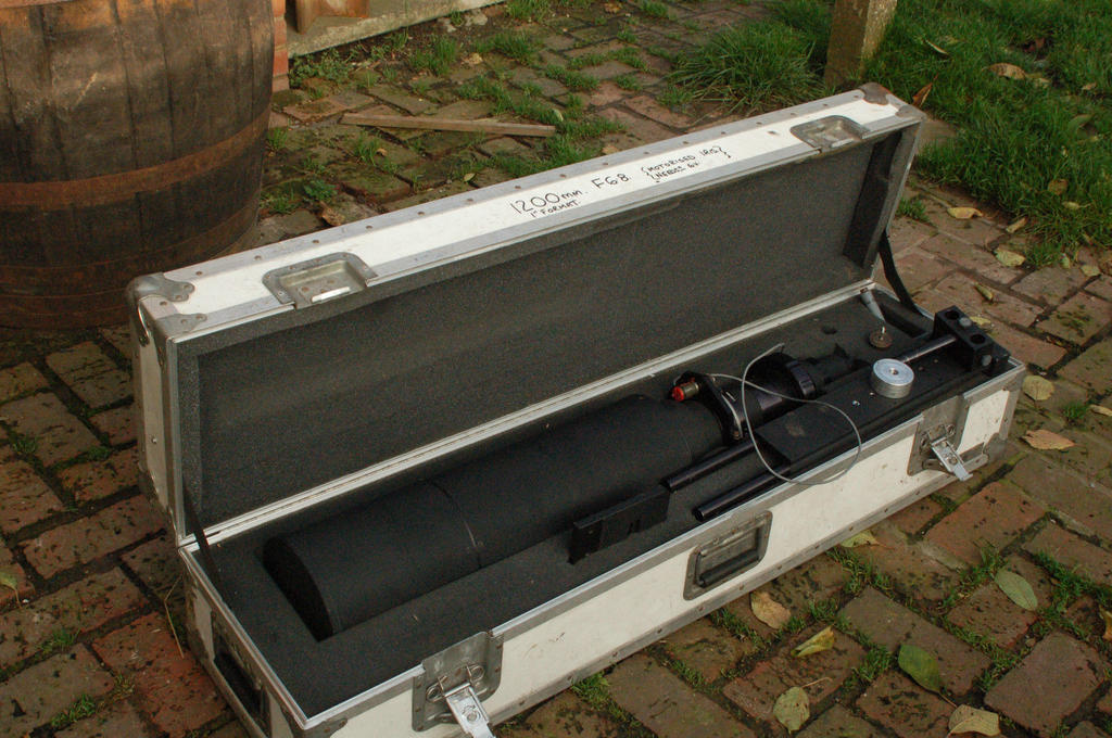

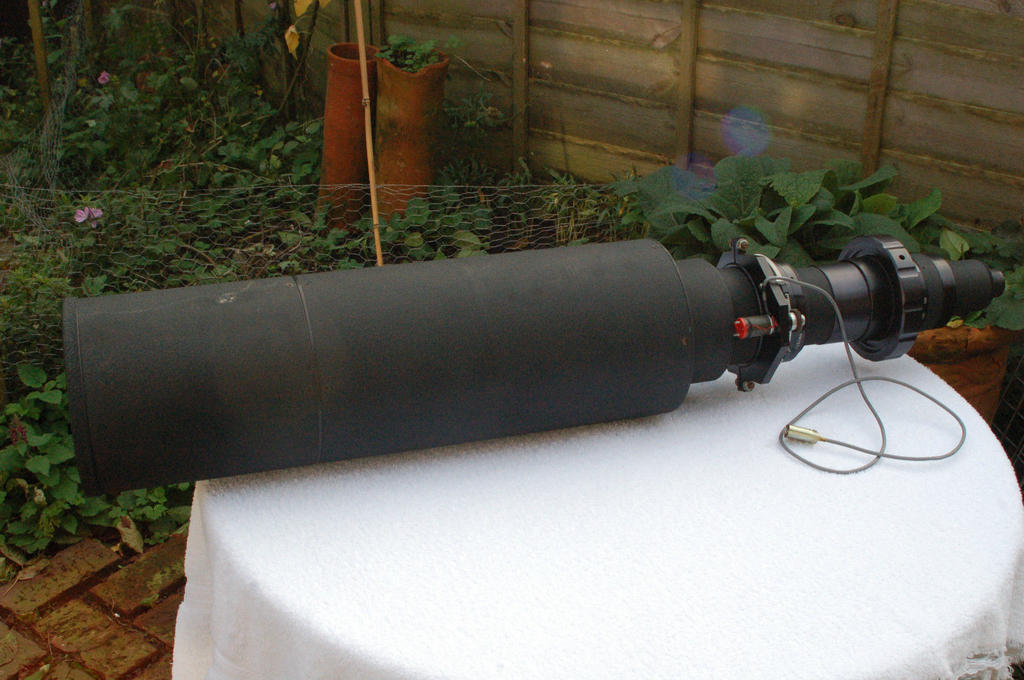

I have acquired a Tele-Athenar II, 1200mm f6.8 1" format lens, made in the USA by Century Precision Optics. This is a monstrous beast of a lens.
Here are a few pics:-
The top image shows the disassembled cradle, the middle shows the actual lens (with pointless aperture motor attached) and the last shows the whole caboodle in its case.

The lens is surprisingly light considering its size, but still heavy enough. It comes with a tripod mountable cradle with “V” shape rollers to the front and a camera body mounting plate at the rear. This cradle is very robust and weighs more than the lens itself. While panning would not be a problem, I would be reluctant to overdo any tilt as it might put undue strain on the lens mount.
I haven’t actually weighed any of it, but it’s for sure that my Manfotto 055 legs and Benro S8 head would not be safe to mount the lens, cradle & body. A problem I’ll address should it become necessary. The lens & cradle are in a dedicated aluminium case of around 1.4m x 0.5 x 0.5m which, when all packed up weighs around 30 – 35kgs. So you see what I mean when I say this is a monstrous beast.
So to the actual lens. The barrels and fixed hood are in pretty good condition, no dings, dents, scrapes or anything else untoward. It has a Nikon F adapter and is a fully manual lens requiring use in stop-down mode. The rear element seems to be in good condition. After a little cleaning, I can see no problems there. The front element also looks to be in good condition, or at least nothing that a good cleaning wouldn’t remedy. To do that properly, I will need to remove the hood, which is fixed in place and needs a very small alan key to undo.
So, here’s the problem. Yes, there had to be one!
At some stage in its life a motor was fitted to drive the aperture ring, though I can’t think why. This clamp on motor is easily removed leaving just the teeth on the outside of the aperture ring. Not a problem. But the aperture blades are a problem. Of the 22 blades, some have dislodged and a few have fallen out of place altogether. Tilt the lens and they can be heard moving inside. There are no click stops on the aperture ring. This may have been disabled when the motor was fitted. Also the aperture ring will not open to its full f6.8, stopping at around f8. Obviously I don’t want to move the aperture ring too much with the blades in their current state.
