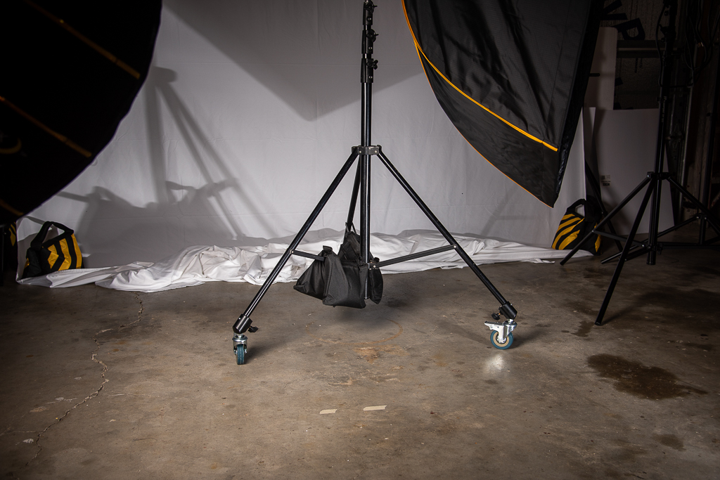

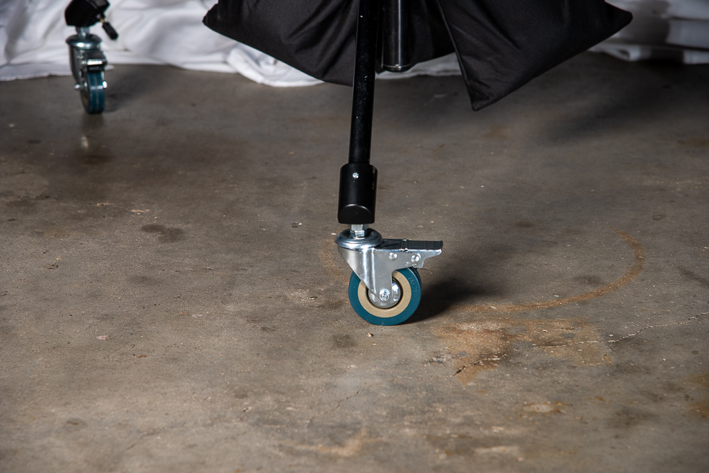

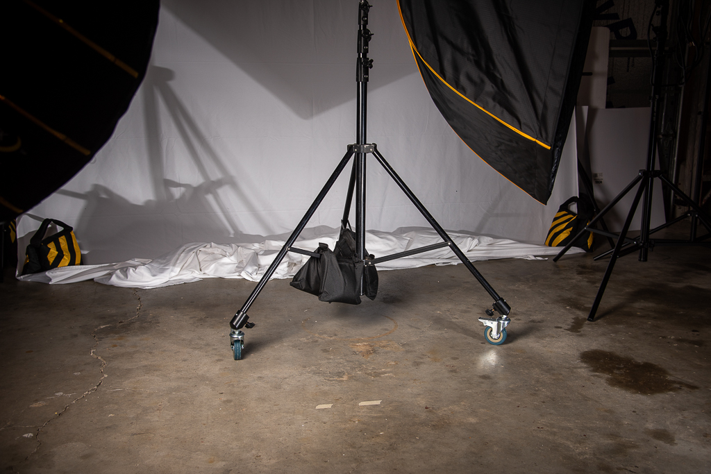

<blockquote data-quote="Andy W" data-source="post: 720393" data-attributes="member: 44106"><p>I got a couple sets of Savage casters for light stands <a href="https://www.bhphotovideo.com/c/product/1400410-REG/savage_cs_c_optional_casters_3_pk.html" target="_blank">https://www.bhphotovideo.com/c/product/1400410-REG/savage_cs_c_optional_casters_3_pk.html</a></p><p></p><p>I had trouble keeping them in place; the weight of the stand/light/octabox/sandbag caused them to rotate on the leg making them inoperable. A screw through the socket and into the leg solved the problem.</p><p></p><p>[ATTACH]326987[/ATTACH]</p><p></p><p></p><p></p><p>The spread of the legs needs to be adjusted so that the casters are straight.</p><p></p><p>[ATTACH]326988[/ATTACH]</p></blockquote><p></p>
