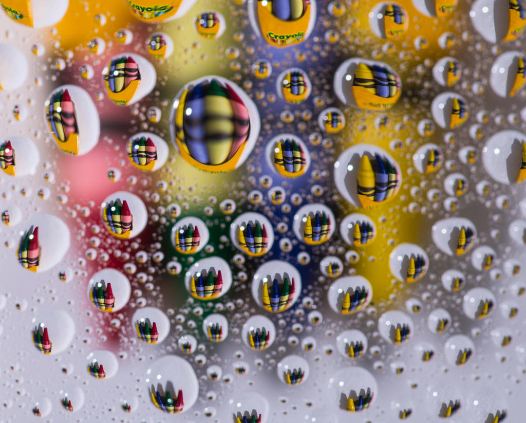

Cant quite get this right looking for ideas.
<blockquote data-quote="singlerosa_RIP" data-source="post: 249160" data-attributes="member: 15556"><p>Here's a shot I did a while back of a 4 pack a Crayons. Nikon D600 with Tokina 100mm macro. ISO 100, f/14, 1/160 sec. Off camera flash - 2 SB-800s; one on each side of glass on manual. Had I not been goofing around, I would have taken more time to eliminate the flash reflection in the water drops. Glass was about 10" above crayons. Sensor was on same plane as the glass. Ditto on RainX and spraying on water. Wait a bit for water to bead up. Good luck.</p><p></p><p style="text-align: center">[ATTACH=full]67493[/ATTACH]</p></blockquote><p></p>
[QUOTE="singlerosa_RIP, post: 249160, member: 15556"] Here's a shot I did a while back of a 4 pack a Crayons. Nikon D600 with Tokina 100mm macro. ISO 100, f/14, 1/160 sec. Off camera flash - 2 SB-800s; one on each side of glass on manual. Had I not been goofing around, I would have taken more time to eliminate the flash reflection in the water drops. Glass was about 10" above crayons. Sensor was on same plane as the glass. Ditto on RainX and spraying on water. Wait a bit for water to bead up. Good luck. [CENTER][ATTACH type="full" width="30%"]67493._xfImport[/ATTACH][/CENTER] [/QUOTE]
