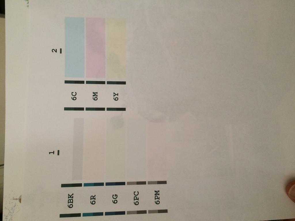

I think there's a bigger problem with this printer, an overnight soak did not fix this partially clogged black ink issue. I'm close to declaring this a total loss and just dumping it... IMG_4599[1].jpg
You can see that every color has the full rectangular block, black is the only one that appears to be missing, and that is confirmed by printing out a picture with a lot of dark areas or black in general...
GSXR_Rider
Swapped print-heads and it works perfectly now!! Also used compressed air to shoot into the nozzles of the print-head and force ink out (this backfired to some extent when ink shot all over my favorite shirt and my face)....
