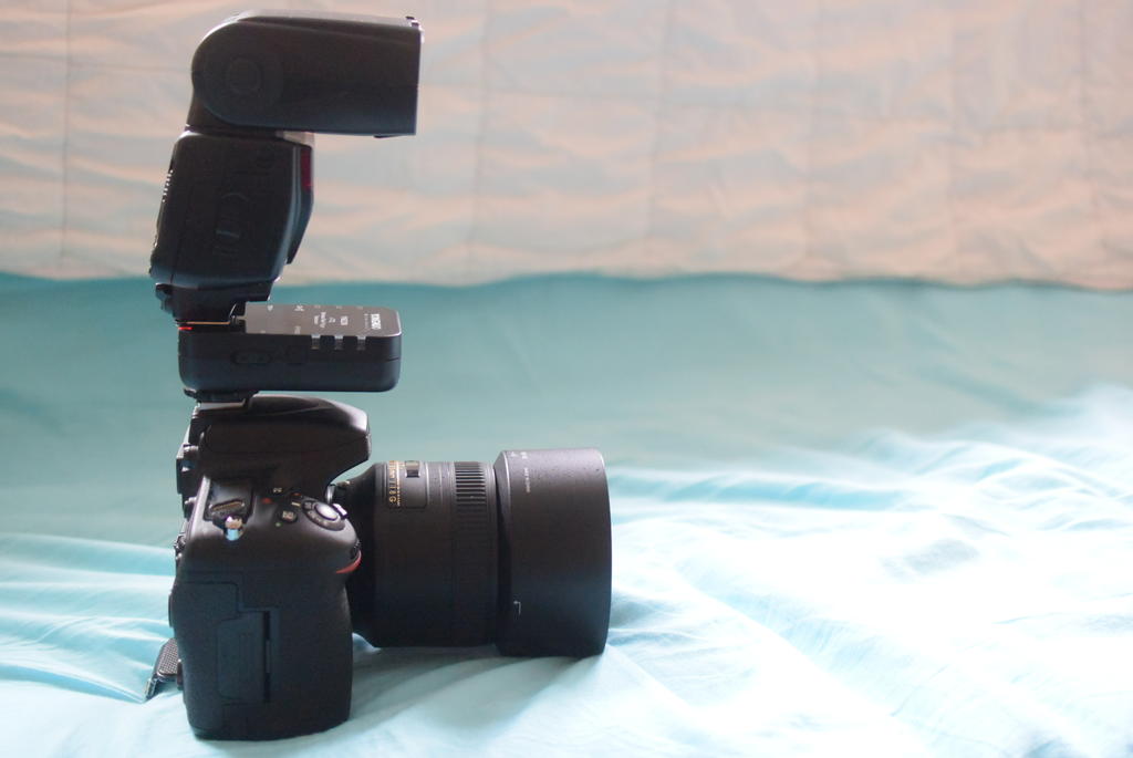

Then I also tried the yongnuo 622n that allowed me to use my sb-700 as master flash (and configure it as weak fill flash) and at the same wirelessly fire my main flash. That works great although as you can see from setup below makes camera bulky and heavy and at the same time it feels less sturdy (you have the feeling that yongnuo 622n will break at camera or at flash mount points). See image below how bulky it becomes
![DSC_5161[1].jpg DSC_5161[1].jpg](https://nikonites.com/forum/data/attachments/186/186946-0e48a949eec2a35dc90670c9063e83f5.jpg)

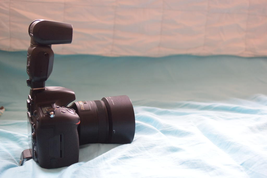

Another option was to leave out of the game the 622n triggers and work with the nikons cls system. Although my research and experience gave me mixed feelings. The preflash would cause subject to blink eyes and reliability is an issue.
The biggest advantage for using the cls system is that the tiny sb-500 flash can be used on camera axis as commander and that is tiny and lightway. I know that this is not a strong flash but it would be great as a fill flash (and much better as trigger system and more more powerful that the in build flash). And even better the flash locks very strurdily in the mount and feel great and very robust.
![DSC_5164[1].jpg DSC_5164[1].jpg](https://nikonites.com/forum/data/attachments/186/186947-d5849724834f9f193174be5fe98590fb.jpg)
