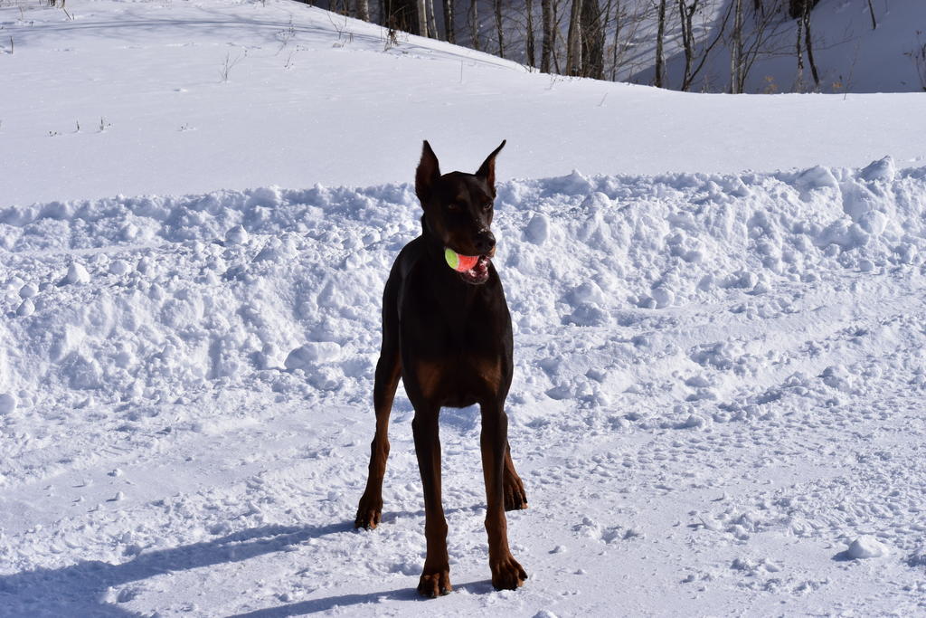

First question. Did the image upload?
Secondly. Shot a bunch yesterday and the subjects are all over powered by the bright snow. Shot on full auto with scene for snow an sand, D5500 with 55-200m lens.

This shot has extreeeeemelyhigh contrast... So, what you're going to want to do is expose for the highlights. This means the snow will be properly exposed for and Fido will appear underexposed. Then you bring up the shadows as best you can using post processing software. If you shoot JPG, you will have a very limited range of exposure before your shot starts to go south on you in a big way. If you shoot RAW you'll have a good 4 stops or so of adjustment before things start to go wonky.

What he said. It's an extreme shot and auto-modes usually don't do well with those.
You can pull some info back in post,; it's there.

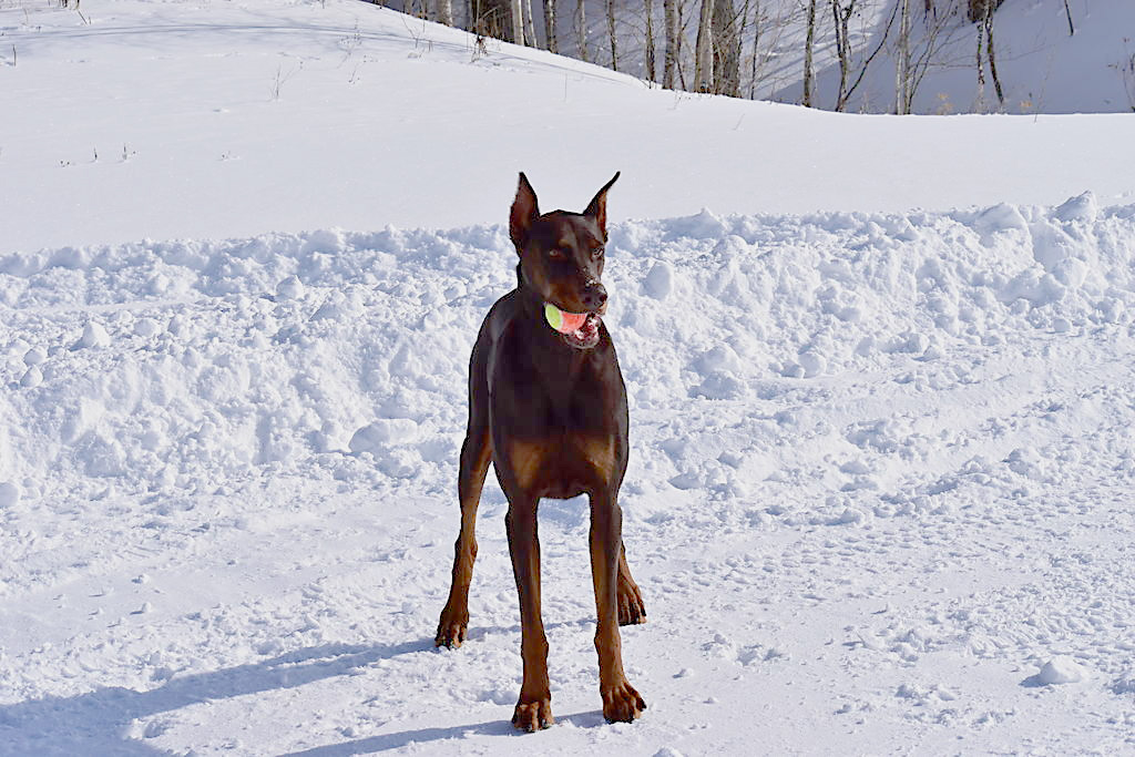

Just some quick work pulling the darks and shadows, not bothering too much about the snow and rest.

The way that light meters work is to try to make all things come out middle gray intensity. This makes the snow be a special problem (white background), it will underexpose to come out gray. That makes the dog dark. About +1 EV Exposure Compensation would have been a good general thing to do for Auto mode in the snow.

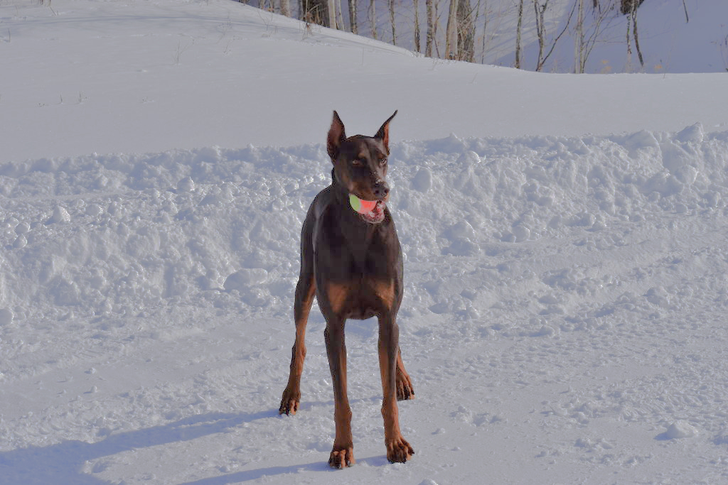

To correct it now, just boosting the JPG is just more problem. But if you have an Adobe Editor (Elements or Photoshop), they have this Levels control (CTRL L). This is the standard histogram tool in many editors (even Faststone has it, menu Colors - Adjust Levels or CTRL L).
Lowering the White Point makes it brighter, but clips badly, just does not come out good here.
But lowering the center point (as marked, raises the center and lower tones, basically it boosts gamma) is brightness which does not change the end points (does not clip). This is an extremely standard tool, good to know.
In this histogram, the large peak is the snow. The smaller middle peak is the shaded upper right corner, and the lowest peak is the dog.

Unfortunately there's not much you can do except, as I mentioned earlier, expose for the highlights and then correct things in post. Your camera can only handle "so much" dynamic range and if it's exceeded, you're going to have blown out detail. If you under-expose you'll blow out the shadows and you'll lose detail. If you over-expose you'll blow out the highlights and lose detail there instead. The idea is to get as close as you can without blowing anything out entirely -- or blow out as little as possible -- and then fix things in post-processing.
