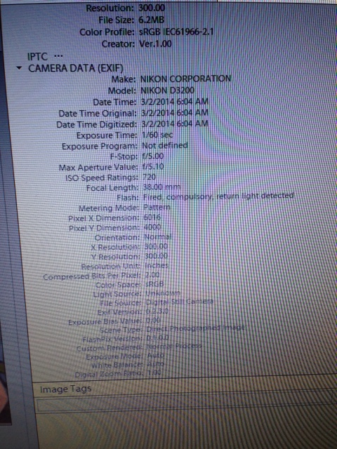

Here is another photo with the same issue. My niece on the left is blurry. Here is the EXIF on the photo also.

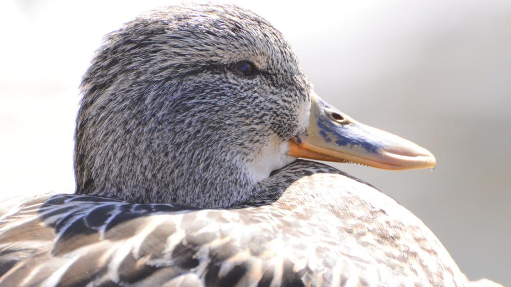

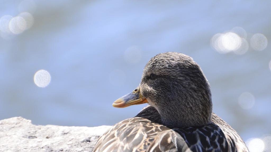

I took these today just to see how they'd turn out with an upclose picture , both pictures are cropped but the detail from the D3200 is pretty good .Getting the camera to do what you want does take some time and lots of practice and tossing lots of pics away.
