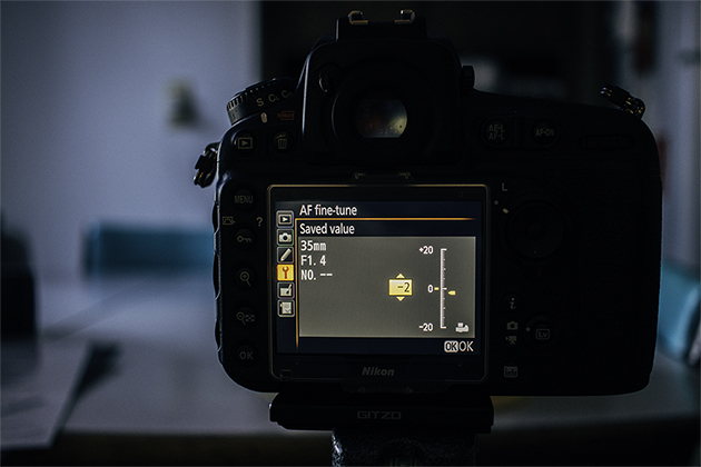

Plus Nine pushes the focus AWAY from the camera. In the first pic, it looks like the wall stuff might be more in focus than the people. That's back focus. If you had back focus problems before, then your internal adjustment should have been a negative number.
Take a steady shot with high shutter speed and wide open aperture shooting down a tape measure or a bookshelf. See if ANYTHING is in focus. If there is a spot where stuff is in focus, then you have to adjust that lens to move the actual focus point back to the point you intended.

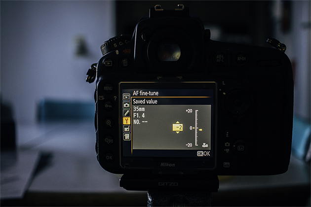

Here's the AF calibration settings menu. See how the camera is at the bottom, and attempting to move the focus closer to the camera makes it a negative number. If you adjusted with a plus number, you may have pushed the focal point behind your subject.
D'oh! I just realized you may have been talking about internal SHARPENING and not internal AF FINE TUNING. Sorry for the confusion.
