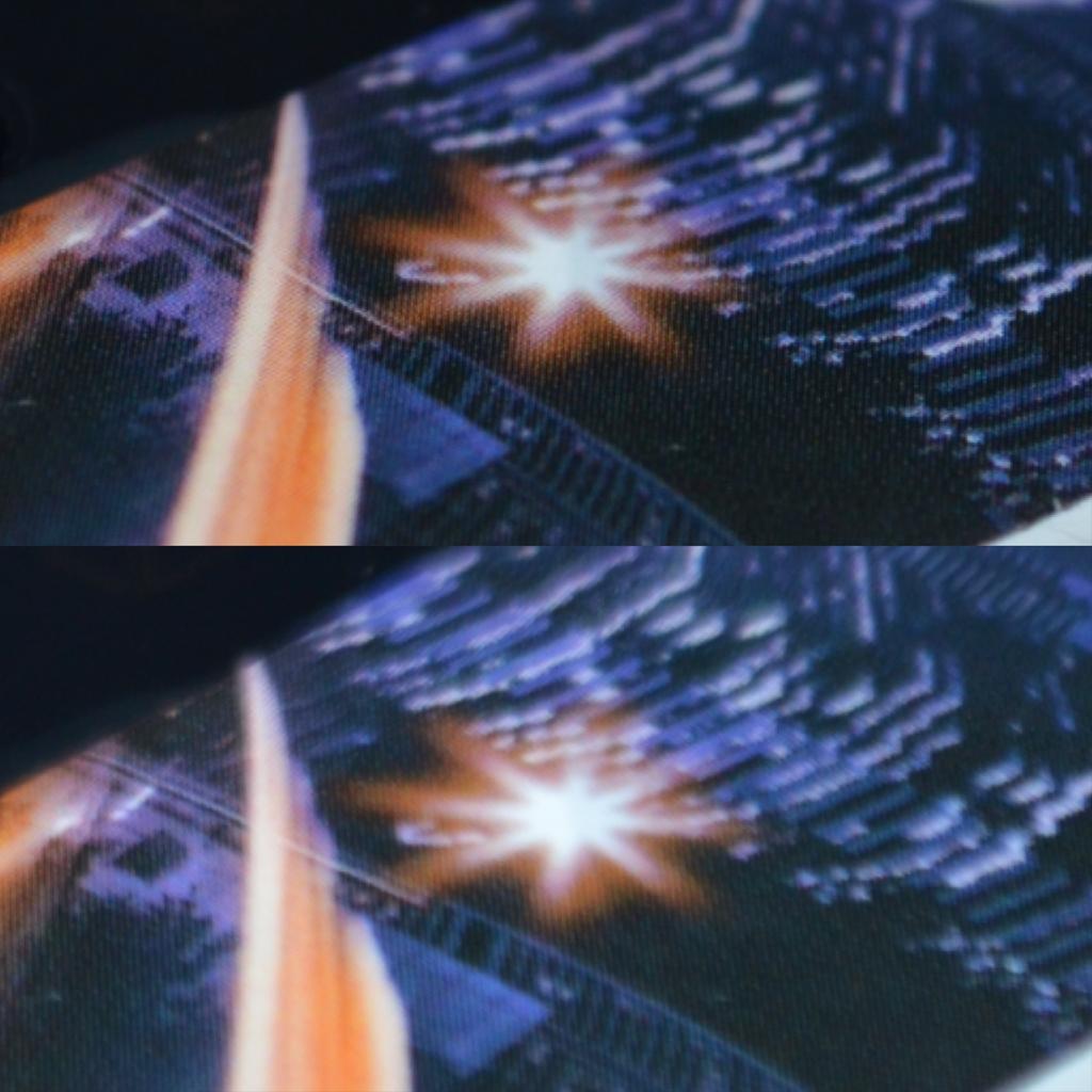

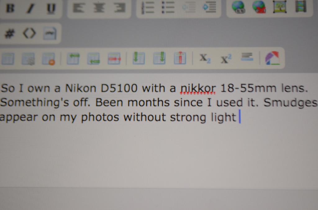

So I own a Nikon D5100 with a nikkor 18-55mm lens. Something's off. Been months since I used it. Smudges tend to appear on my photos without strong light. I pictured pixels on a monitor to assure that it is taking sharp photos. Do you think it's the weather or something? Room temperature? Anything?

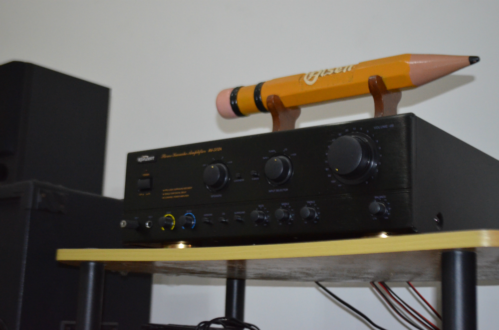

So here is a picture of it using auto mode without flash:
F-stop f/4.5
Exposure Time 1/30 Sec.
ISO Speed ISO-3200
VR Off
This picture was taken hand held. The first one was taken on a flat surface.
BackdoorArts
Do you have a UV filter on it? If so, is it a "good" one? If you don't know, take it off and try shooting without it and see if this goes away. The stereo photo simply looks out of focus. The monitor photo seems focused in the center but soft on the edges. Cheap filter could definitely be a problem. Dirty element could be another issue.

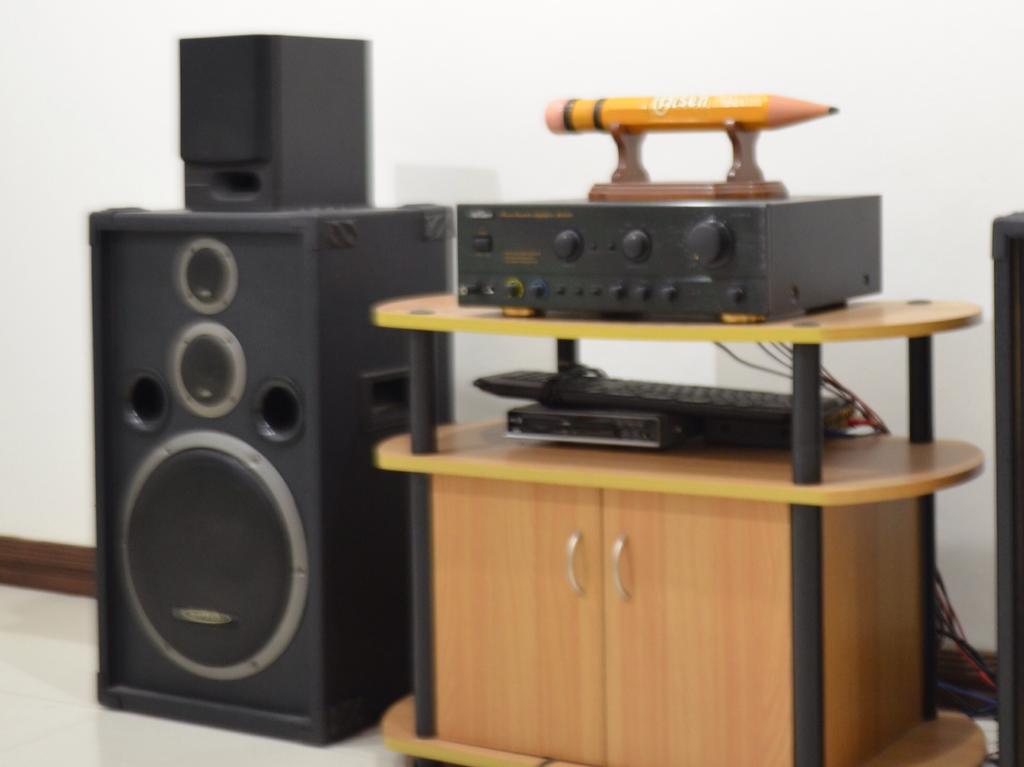

Auto mode with flash:
F-stop f/5
Exposure Time 1/60 sec.
ISO Speed ISO-3200
Picture was also taken hand held.

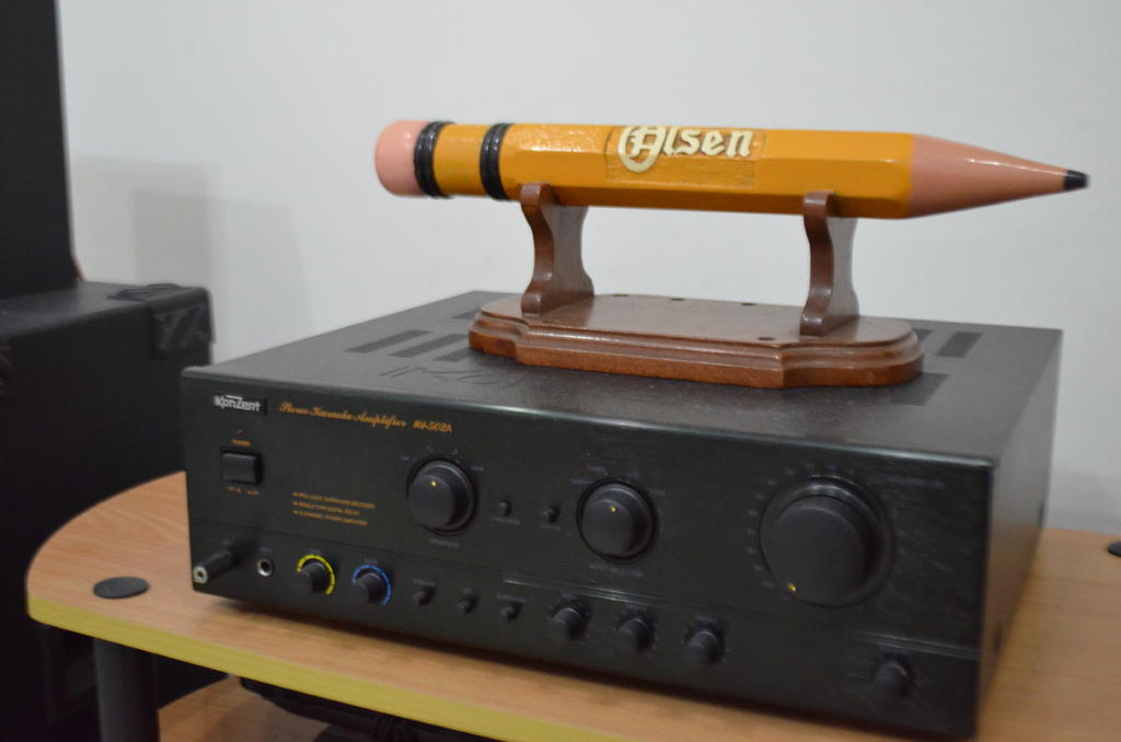

Sample of a photo I took a year ago. I was totally clueless on how to use program or manual mode. So I used auto mode back then.

Could you try a few images outside in daylight? Aperture 8.
Focus on a thing, simular to your stereo.
On the image without flash, you write 1/30, thats a pretty low shutter so easy to shake.
