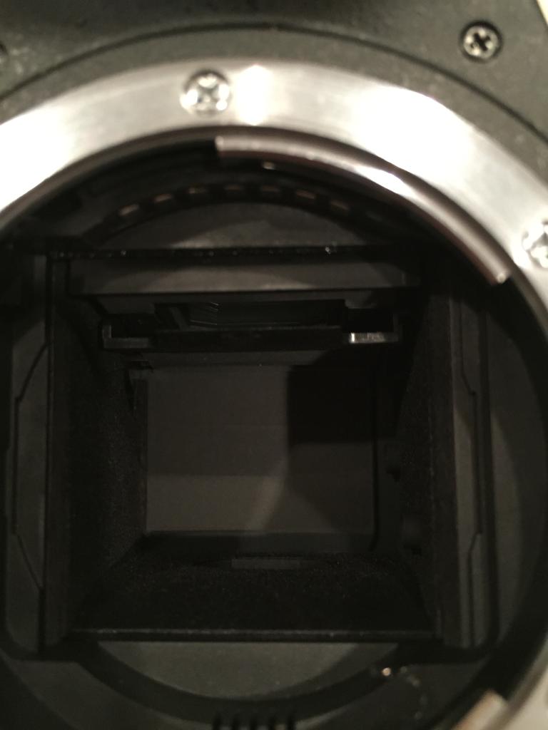

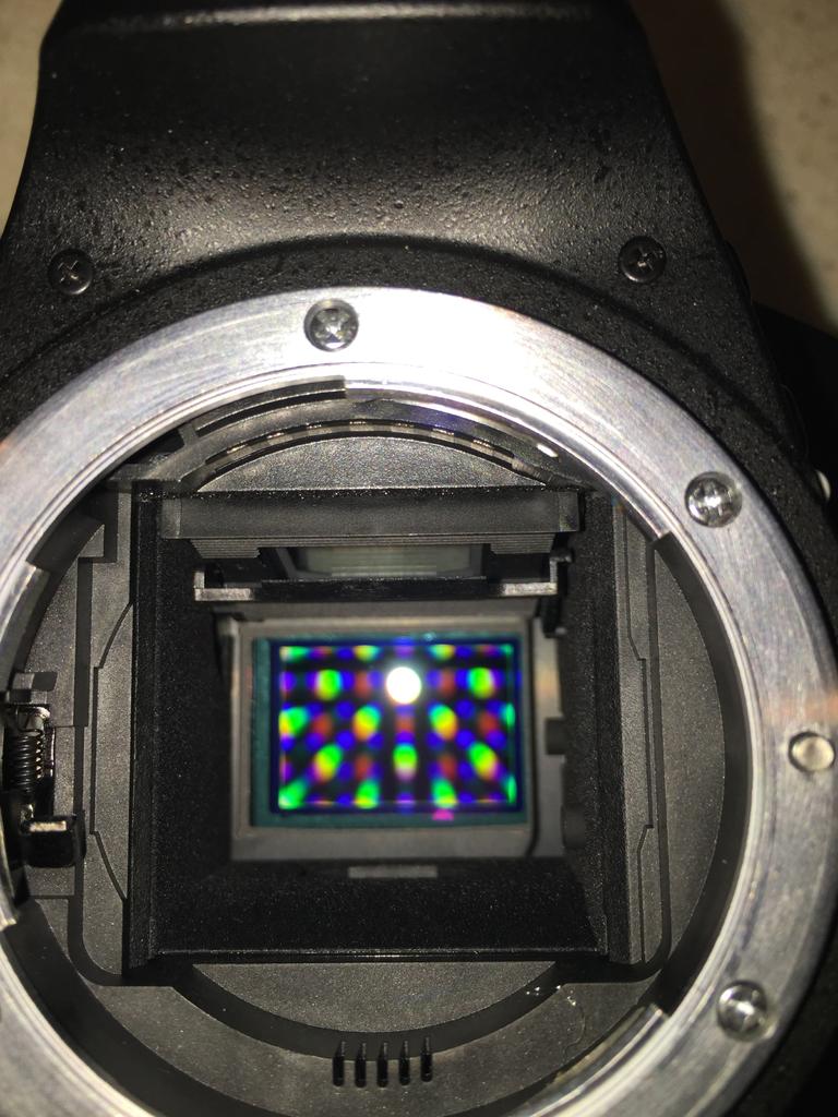

Boatboy24
OK, I don't know if it'll help, but here are a couple pics. The first is with the camera off, and in the second the camera is on and I've locked the mirror for cleaning.
nickt
Is that a mirror in the first shot? it looks dull, but maybe its just how the light falls. I'm getting over my head here... I'm not not sure if the mirror has some kind of separate back plate or what, but that first shot should be a shiny mirror on a 45 deg angle. If you look up toward top of camera, you should see your focus screen. It looks kind of like a skylight on the ceiling.
The 2nd shot looks like a normal shot of the sensor.
