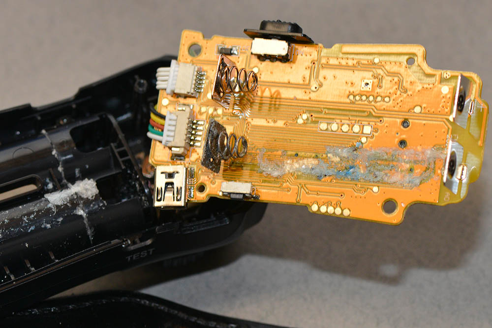

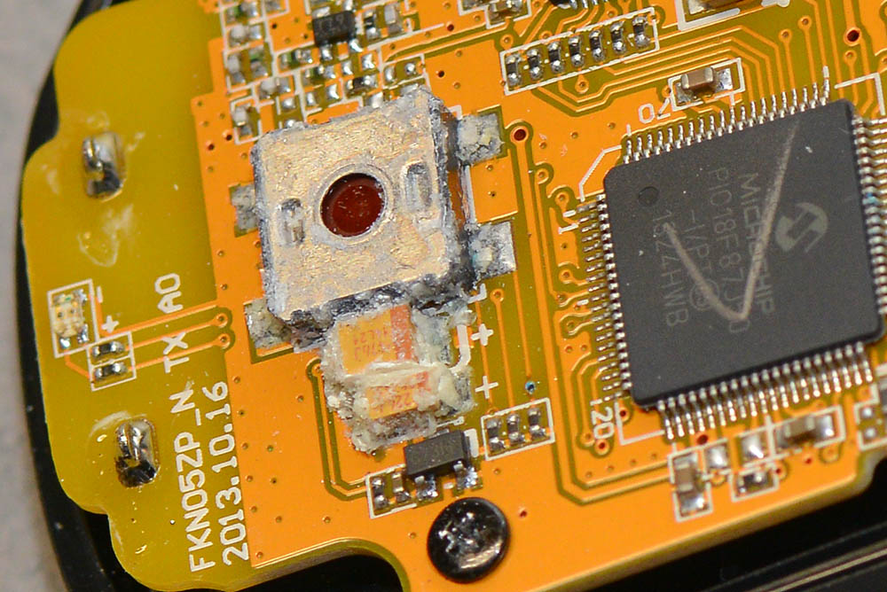

The Phottix transmitter screen was acting wacky and would not connect to the receiver. When I opened the battery case, the Energizer batteries had corroded, and they had leaked onto the circuit board inside the transmitter. I opened my Mecablitz flash and discovered the Energizers in it had also corroded.
Luckily, I was able to open the transmitter and clean the gunk off the circuit board. It worked after that. The lesson is to check your equipment regularly. For these items, I will no longer store them with the batteries inside.

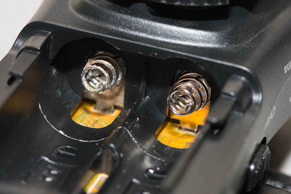

You can see the design exposes the circuit board right under the battery connections:

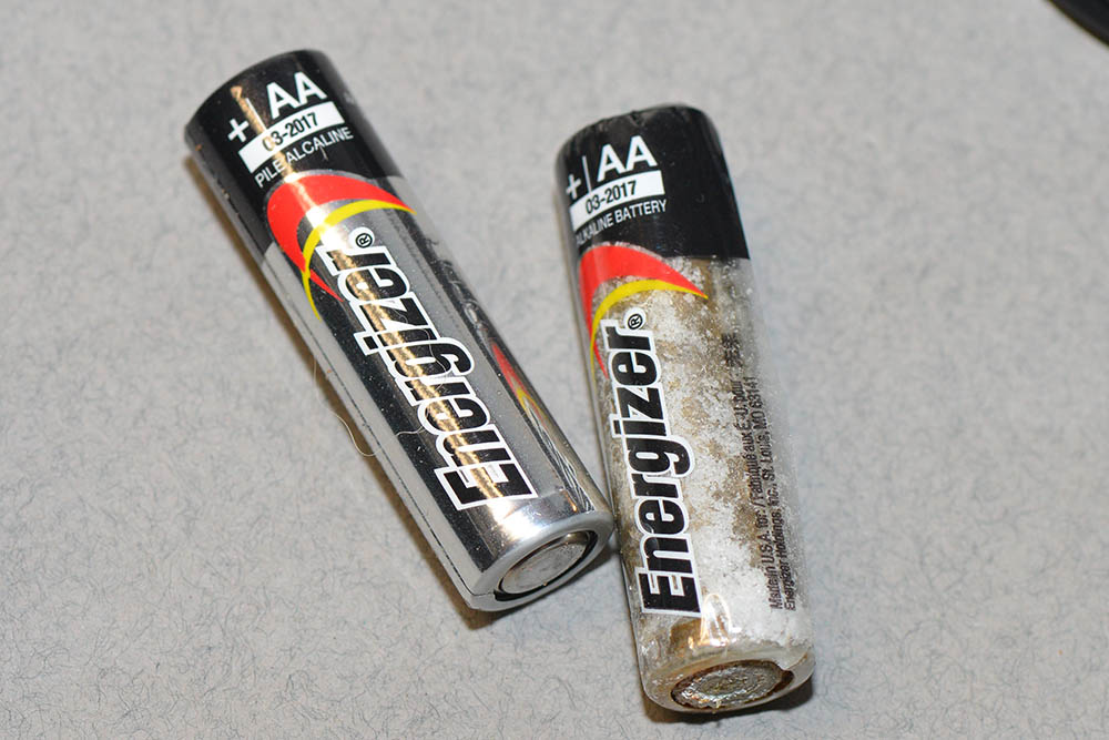

The culprits! @#$%^%@$

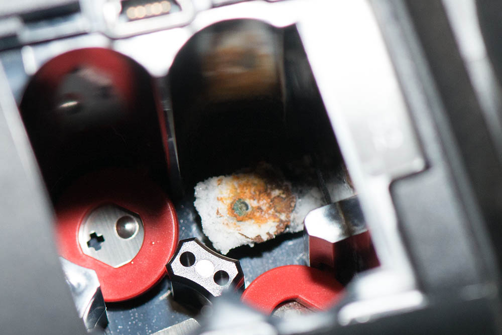

Inside of flash:

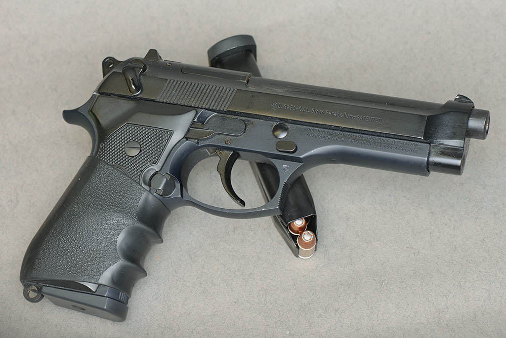

Nice gun but what has it got to do with the batteries ??
The pistol was my intended subject for the evening, but then I discovered the battery problem and had to fix the flash trigger and clean out the flash. I shot a few of the pistol once everything was back together.

Good idea to contact energizer as Fish said. Corrosion will come back to haunt you. Especially on battery contacts. Once they lose that nickle plating (or whatever it is) and the base metal is exposed they will always need a little maintenance to keep them making good contact. If there are any salts left behind in little crevices after cleaning they will continue to do damage.

Nice Beretta.

Nice weapon... I have one of those handy in the house. I will agree with everyone else on the Eneloop batteries. I finally broke down and bought some to try in my speed light and they are really amazing. I now have more.
