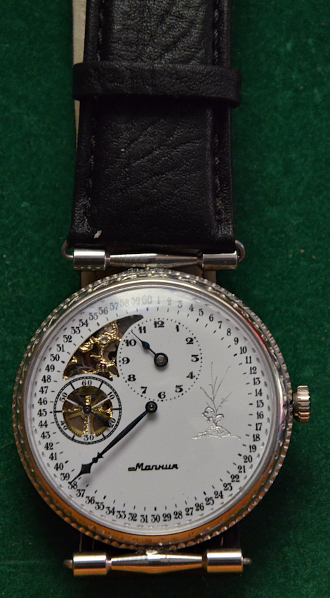

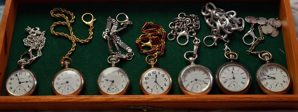

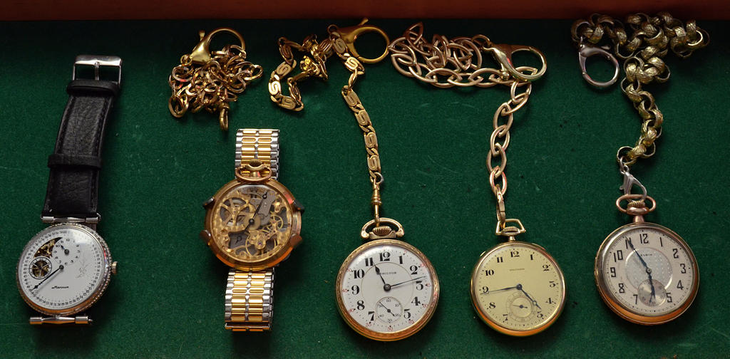

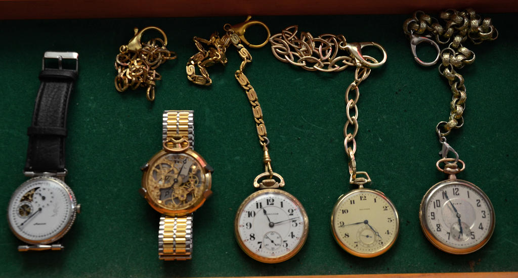

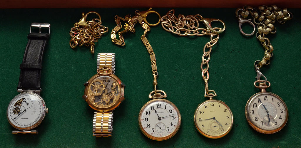

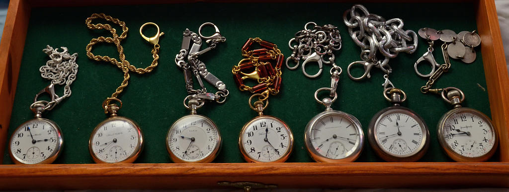

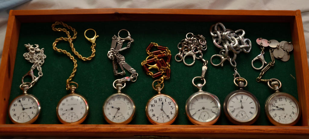

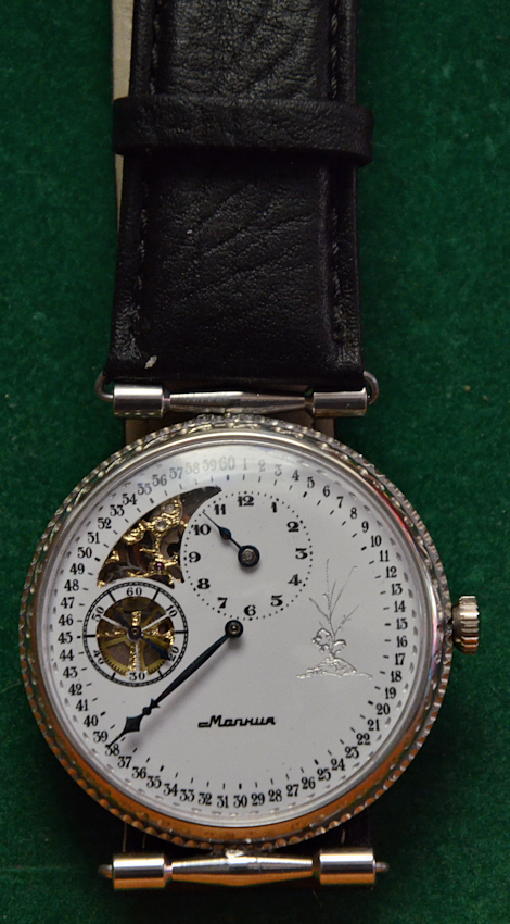

<blockquote data-quote="Marcel" data-source="post: 690696" data-attributes="member: 3903"><p>I have a few questions in order to try solving your IQ quest.</p><p></p><p>Are you using a tripod for your shots? As I look at your exif, it seems to me that your shutter speeds are on the slow side. If hand held, this could lead to a great loss of sharpness.</p><p></p><p>In the case of the watches, if you would have used a tripod, you could have focuses using Live View, magnifying the screen while in LV and then manually focus exactly where you wanted the focus to be.</p><p></p><p>If you are shooting hand held, try to use the Quiet shutter mode. I did some experiments earlier when I had the D7000 and found that using the quiet mode gave me consistently better sharpness than the single shutter mode. It seems the D7000 had a case of mirror slap (camping the mirror stop in the up position) that caused this.</p><p></p><p>Good luck and keep trying. I'm certain you can get great results with the D7000.</p></blockquote><p></p>
