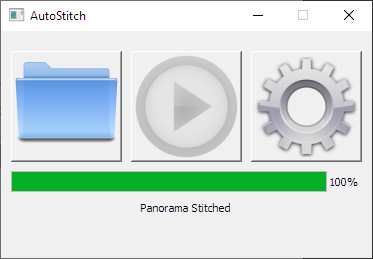

<blockquote data-quote="Fred Kingston_RIP" data-source="post: 783626" data-attributes="member: 10742"><p>It's kind of convoluted but, here goes...their installer is sort of non-apple-professional</p><p></p><p>Once you try to install this app. it will give you the previously mentioned message about malware etc...</p><p></p><p>Click on System Preferences... <--that's in the Apple icon upper left corner...</p><p>then click on the Security & Privacy icon</p><p>be sure the General Tab is active</p><p></p><p>You first need to UNLOCK the screen to the lower left with that big lock icon and enter the computer's admin password.</p><p></p><p>Look to the bottom of the open screen and you should see a message about trying to install unsigned developer apps. and it specifically mentions this one... and then gives you the option to over-ride the system and ALLOW installation from that Developer...</p><p></p><p>click to Allow...</p><p></p><p>Wait, we're not done yet...</p><p></p><p>Now that all that has been done, the Stitch program has created it's own drive/folder on your desktop...</p><p></p><p>You'll now have to drag the Stitch.app file from that mess on your desktop to the Application folder on your computer... otherwise, you'll have to go thru the above re-validation process... </p><p></p><p>I didn't have a series of images to test with... so didn't... so I don't know what happens after all the above...</p><p></p><p>Good luck... the interface looks a bit 1970's to me...</p></blockquote><p></p>
[QUOTE="Fred Kingston_RIP, post: 783626, member: 10742"] It's kind of convoluted but, here goes...their installer is sort of non-apple-professional Once you try to install this app. it will give you the previously mentioned message about malware etc... Click on System Preferences... <--that's in the Apple icon upper left corner... then click on the Security & Privacy icon be sure the General Tab is active You first need to UNLOCK the screen to the lower left with that big lock icon and enter the computer's admin password. Look to the bottom of the open screen and you should see a message about trying to install unsigned developer apps. and it specifically mentions this one... and then gives you the option to over-ride the system and ALLOW installation from that Developer... click to Allow... Wait, we're not done yet... Now that all that has been done, the Stitch program has created it's own drive/folder on your desktop... You'll now have to drag the Stitch.app file from that mess on your desktop to the Application folder on your computer... otherwise, you'll have to go thru the above re-validation process... I didn't have a series of images to test with... so didn't... so I don't know what happens after all the above... Good luck... the interface looks a bit 1970's to me... [/QUOTE]
