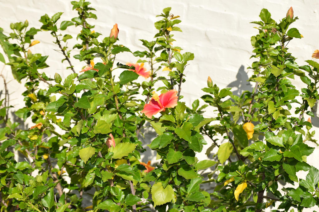

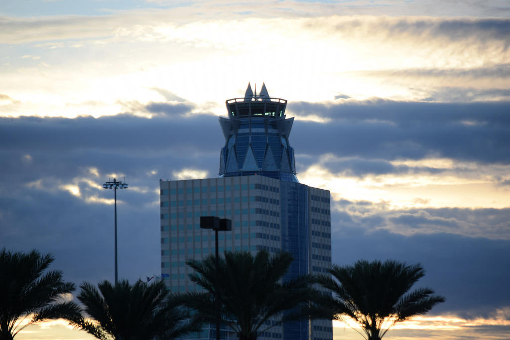

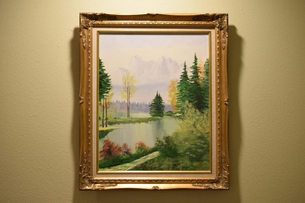

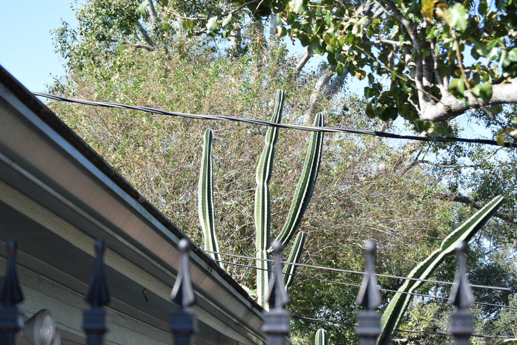

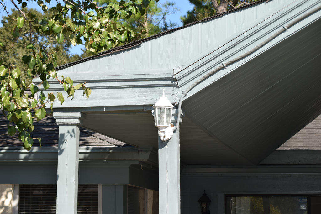

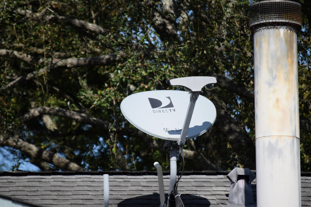

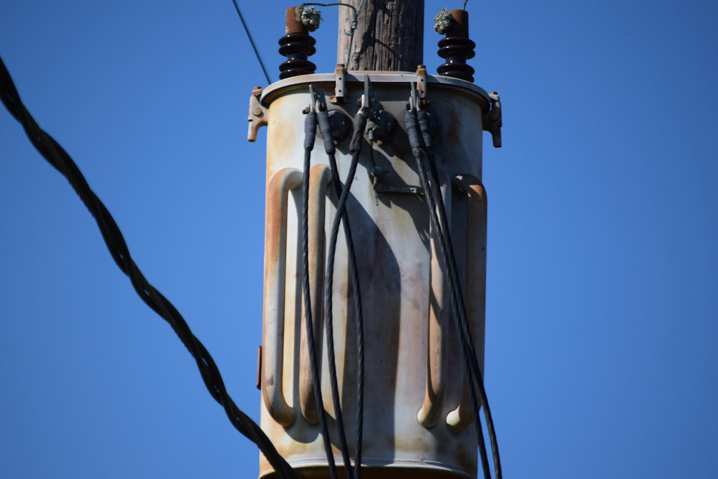

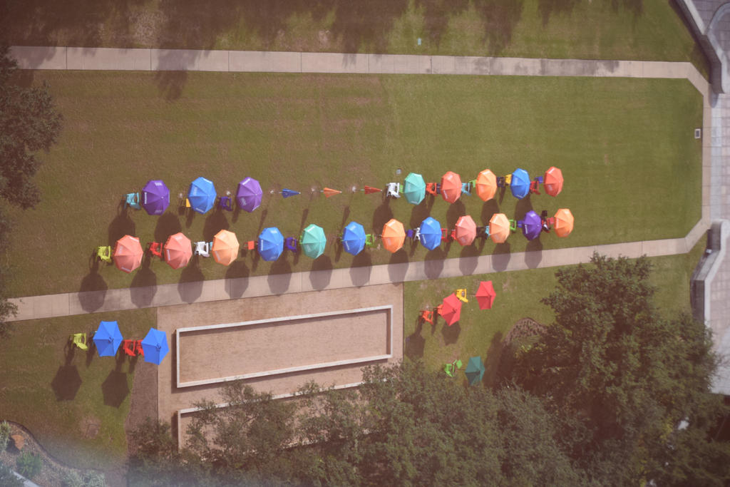

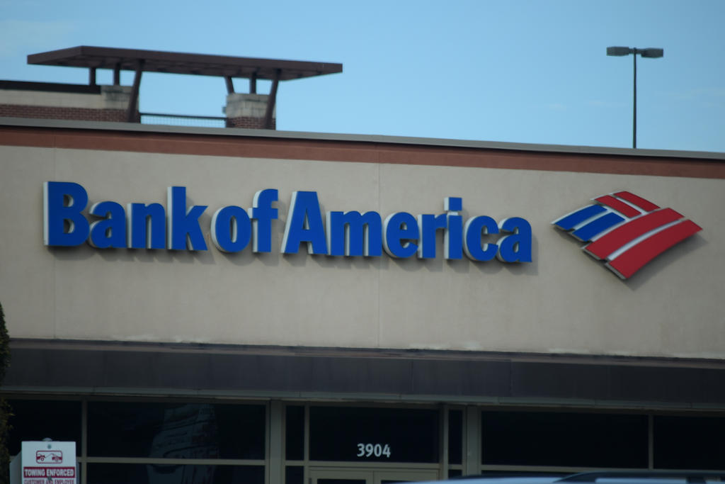

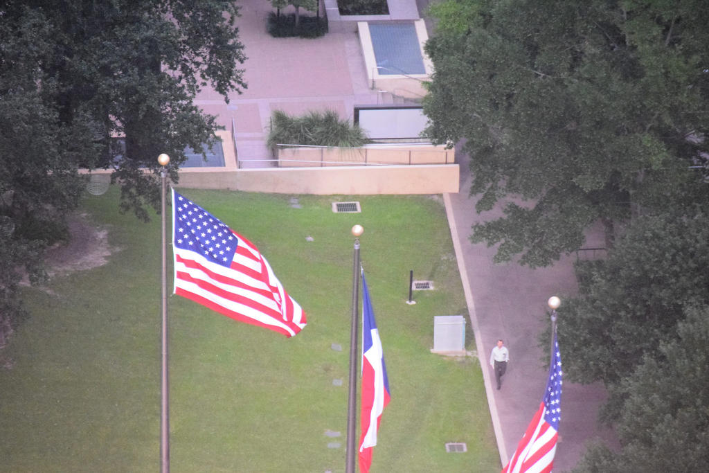

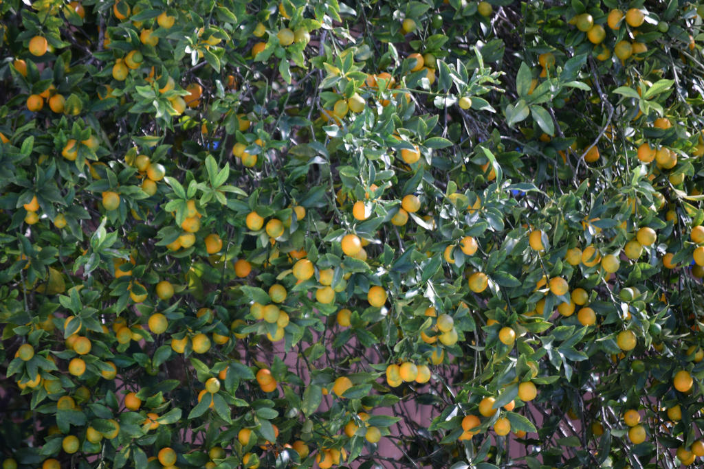

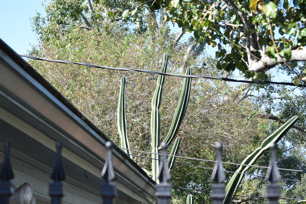

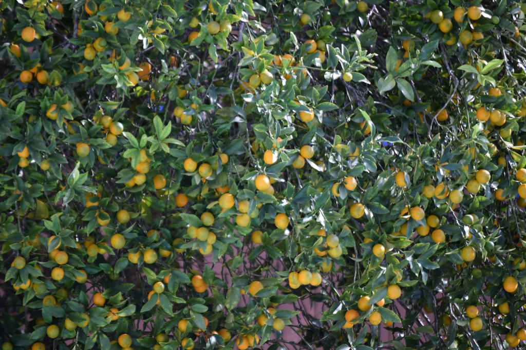

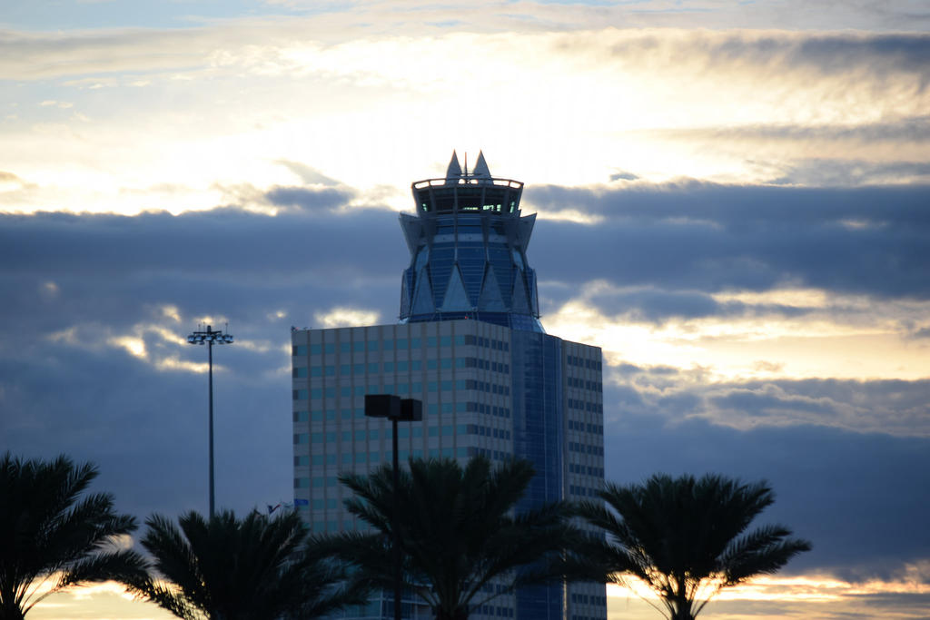

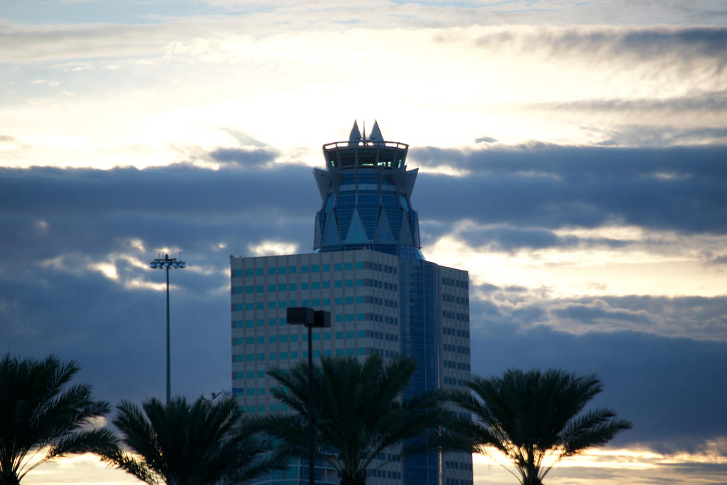

Sample images below. These are all OOC Jpegs. Except the first photo taken with a 50 f/1.8 Series E prime, all the others were taken with the 55-200 VR. One thing I noticed right off the bat while going through the photos were that many of them were taken with shutter speeds way faster than the reciprocal rule, although I did have VR on (which could be good or bad going by comments above). Sorry about the lame artistic quality of the photos!
Horoscope Fish
The EXIF data has been stripped out of the shots you posted so we can't see what the settings were when you took these shots -- focal length, aperture, shutter speed, ISO, etc., all of which would be very helpful. They're also really small JPG's so it's hard to tell much about how soft or sharp they are. Can you pull a JPG or two off your camera's SD card, copy it right onto your computer and then attach it here? We really need that EXIF data if it's at all possible.
That being said, and based on looking at your posted images, I'm seeing some really wonky colors in the third shot (beach umbrellas and chairs on the lawn) and most of your shots appear to me to have exposure issues (sometimes over, sometimes under).
For starters, I suggest you put the Contrast setting back to zero. I'd ask that you make sure you don't have any Exposure Compensation enabled. To check this setting press the "+/-" button near the shutter and turn the rear Command dial. The "+" numbers lighten the exposure, and "–" numbers darken it; make sure the setting reads "0". Also, if you haven't already, set the File Size setting to "JPG Large" and, lastly, while we're troubleshooting issues, turn off the VR function and leave it off (for now).
Once you've done those things, I'd like to see some basic shots taken with the same 55-200mm lens. Outdoors, with full sun if possible, and shot using the Green Auto Mode. They don't need to be "art" photos, I'd just like to see some full size JPG's, taken outdoors in the best possible shooting conditions.

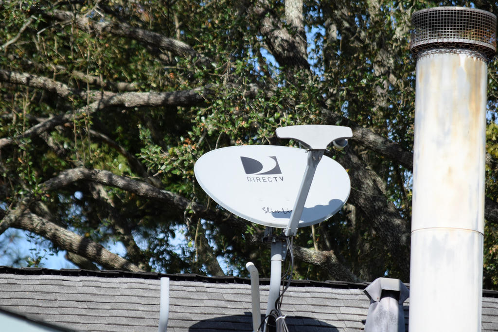

Most of your shots seem to clean up pretty well with a little post processing so I'm thinking this is a settings-related issue. Here are a couple I touched up lightly:

Yes, they were auto uploaded from my Mac to Flickr, from where I downloaded them in "Large" size to post here. Not sure why that stripped out the EXIF?! Good point on the vignetting, hadn't even noticed! I have noticed exposure issues though, and feel that something is off with the D3300 metering with this lens (or maybe in general).

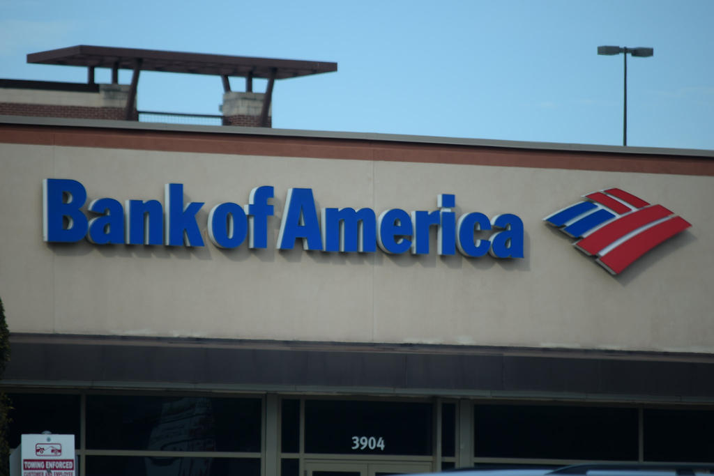

I have re-posted a few of the above JPGs as you suggest, but had to downsample them they were originally "Fine" JPGs and too large to post. I'll work on taking a few more shots as you suggest in the next few days and post for your review.

Well we can rule out Exposure Compensation. That's a shame because it would have been a slam dunk of a fix.
I think resetting the Contrast setting will help and as for the vignetting it's funny, some images I clearly see it, others not so much. I edited my first post because I was unsure. I'm wondering now if it's not simply an issue with the 55-200 itself when shot at its longest focal length.
The exposure issue may be something you need to deal with by turning ON Exposure Compensation. The images seem pretty sharp already, but a little touching up in Photoshop isn't hurting them any either.

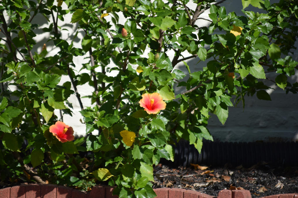

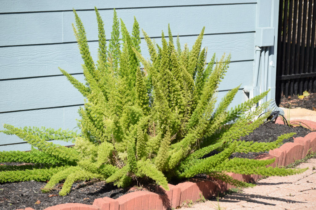

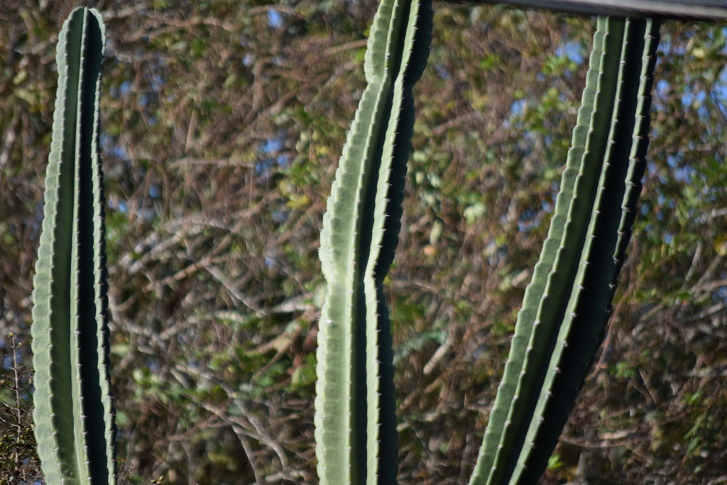

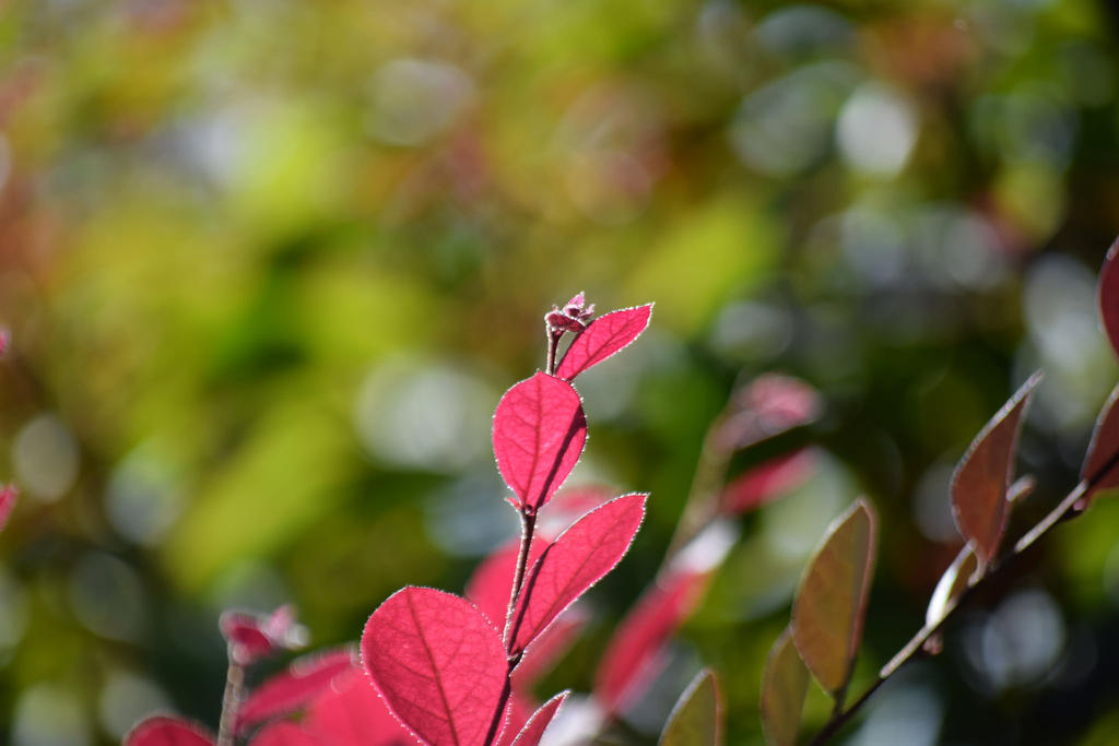

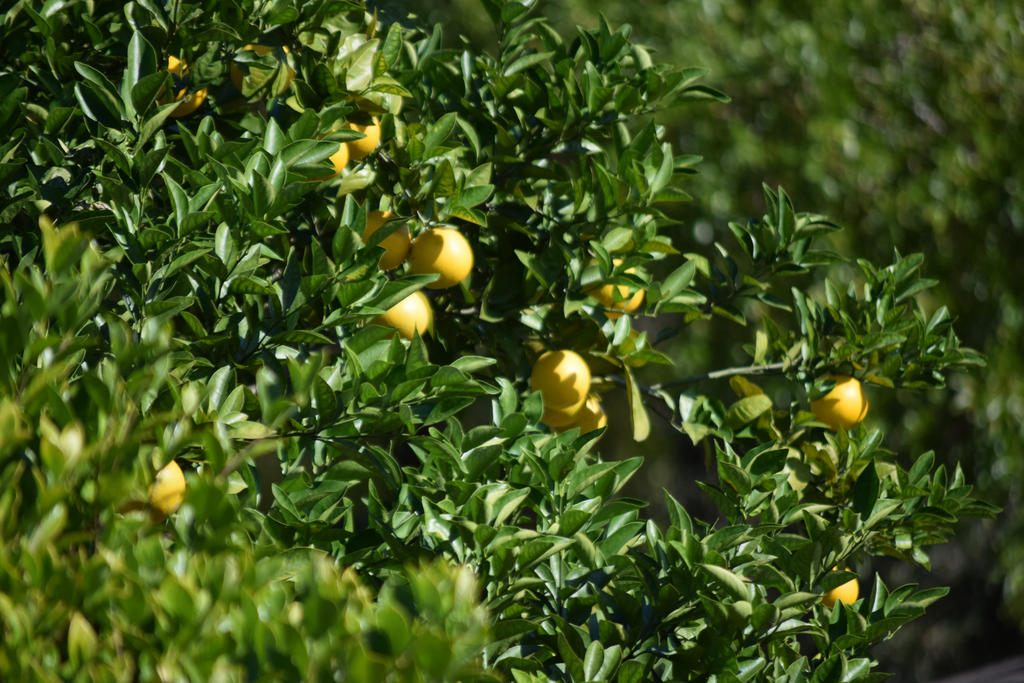

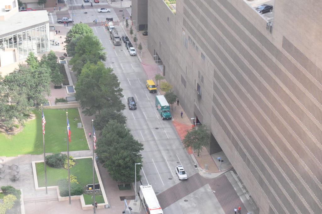

Got a chance today to take some photos as per your instructions. I wasn't able to upload the full-size OOC jpegs, so proceeded to downsample them to 2048 pixels wide using the Mac Photos App. You will see several pairs of the same subject taken at 55 and 200mm. Looking forward to your feedback / verdict, thanks so much!
