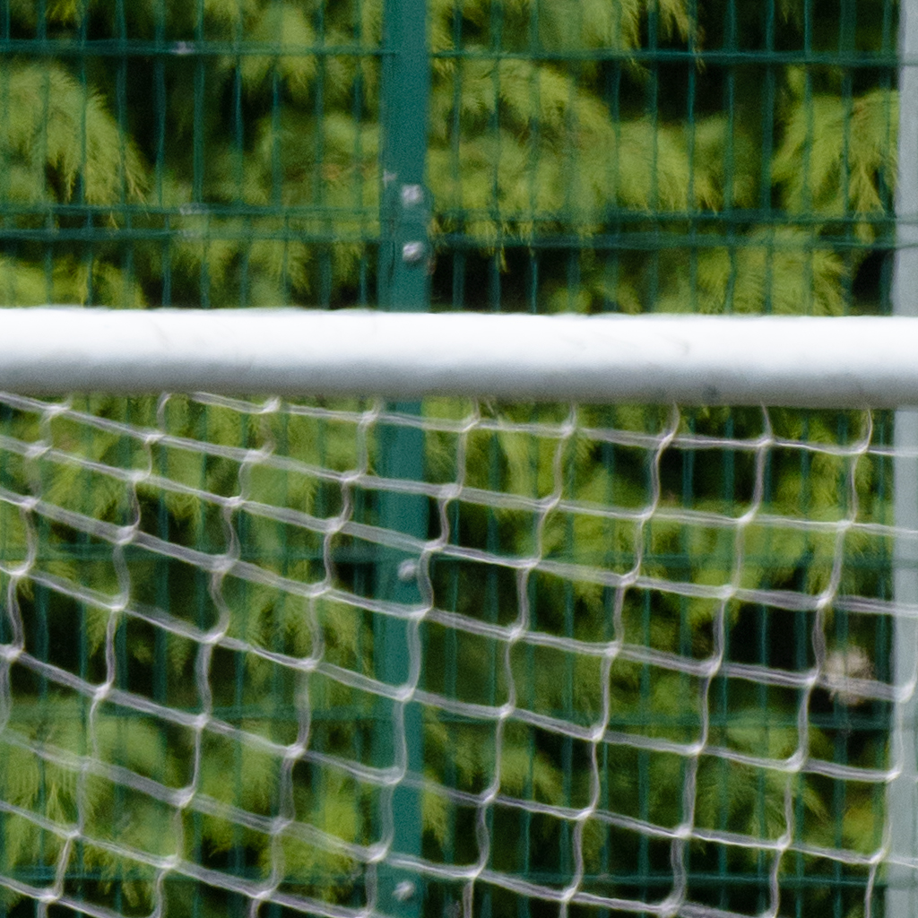

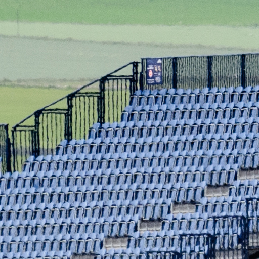

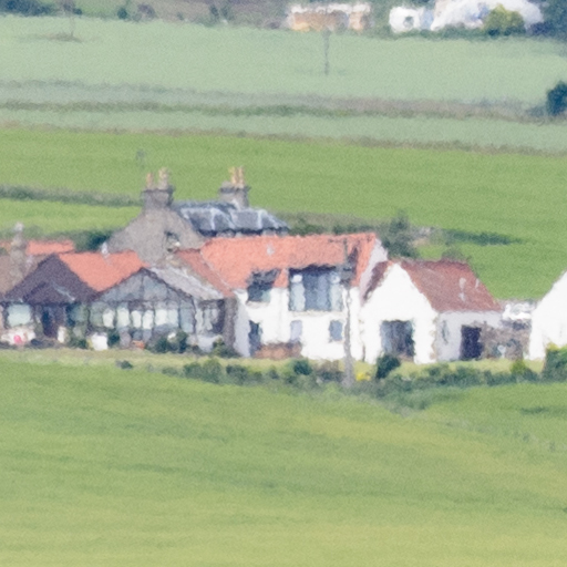

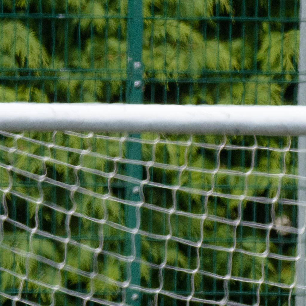

Have a look at this small crop of a telephoto picture:
Doesn't look very pretty, does it? I can assure you, this is not a lens problem, this is not front or back focusing. It's the air. Have a look at another crop from the same shot:
You can clearly see the distortion at the uprights in the barriers. This is called scintillation and it is due to rapid small-scale changes in air density between the camera and the subject. This is simply hot air going up. The picture was taken from about 500 m on a hot day.
I started noticing this effect when I tried to test my new Sigma 150-600 at infinity. I put it on a tripod and focused on a distant target. Then, I noticed that the image in the viewfinder (or even more in live view, when you zoom in) is twinkling and shimmering. Any picture taken in such conditions, regardless of the shutter speed, would be blurred, as above.
I wonder how much air scintillation affects typical wildlife photography. I guess it doesn't matter that much at shorter distances, let's say 50 m. There is not enough air between the camera and the animal to make a significant distortion. But at longer distances on a hot day? It might contribute a lot to a softness of the resulting image. So, some of the telephoto pictures we take can be limited not by the lens or sensor, but... by the weather.

The ideal use for a long lens is a small closer subject made bigger,apart from scintillation you have all the dust ect in the atmosphere which all help to degrade an image.

Living in Southern California I deal with this on occasion since deserts and beaches are both great sources of what I know as heat-wave diffraction (I've never heard it called "scintillation" before). It can be frustrating but I've just come to think of it as One of Those Things that plague us as photographers.
The best solution I've found is simply avoiding it by shooting during the cooler parts of the day. If that's just not possible you can try to get closer to minimize the effect but if THAT'S not possible, well... At that point you're pretty much screwed.
Whiskeyman
Yep. You can have the best equipment made, but the laws of physics will still win out. :)
Yeah! Like "Gravity: It's not just a good idea; It's the law!!!"
Back to the OP's question, though. I wouldn't say that the telephoto lens is limited, but that your subject is.

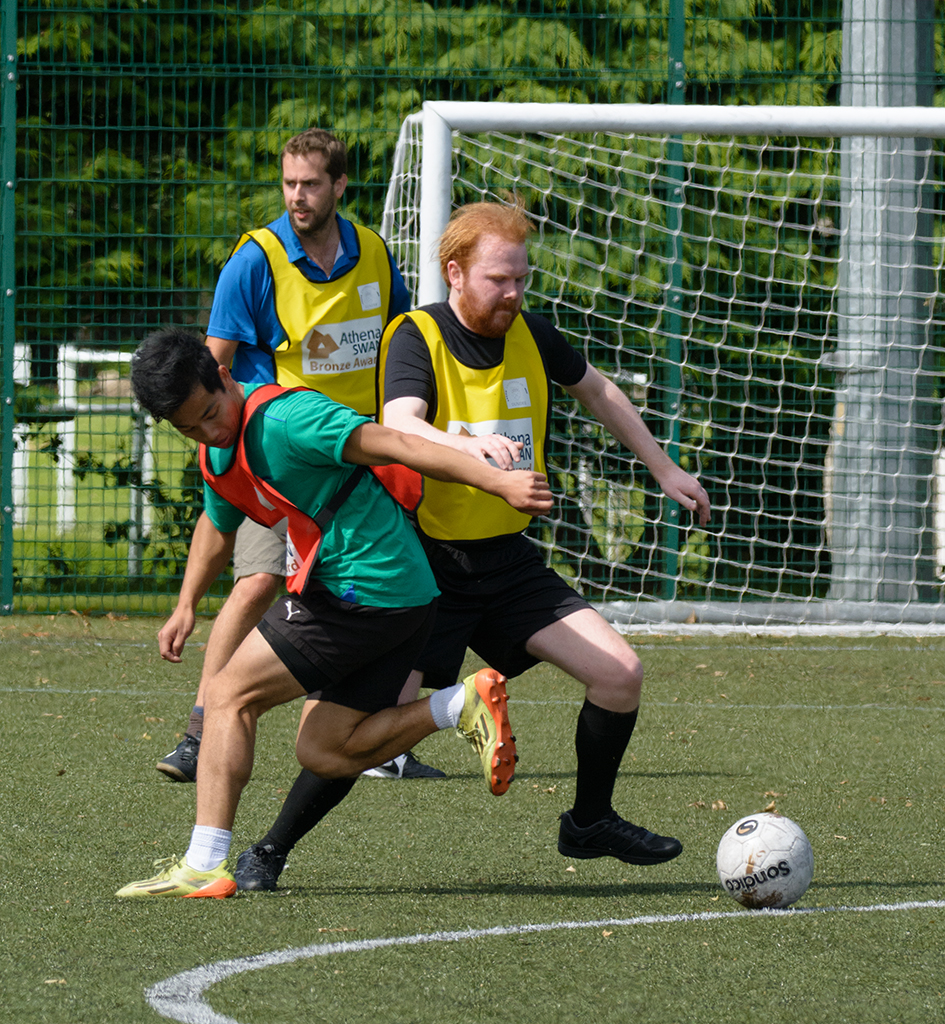

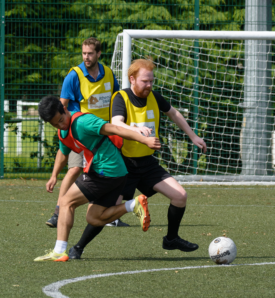

Another example, this time from a much shorter distance of about 30 m. The sun just came out and I was happy with lower ISO in my shots.

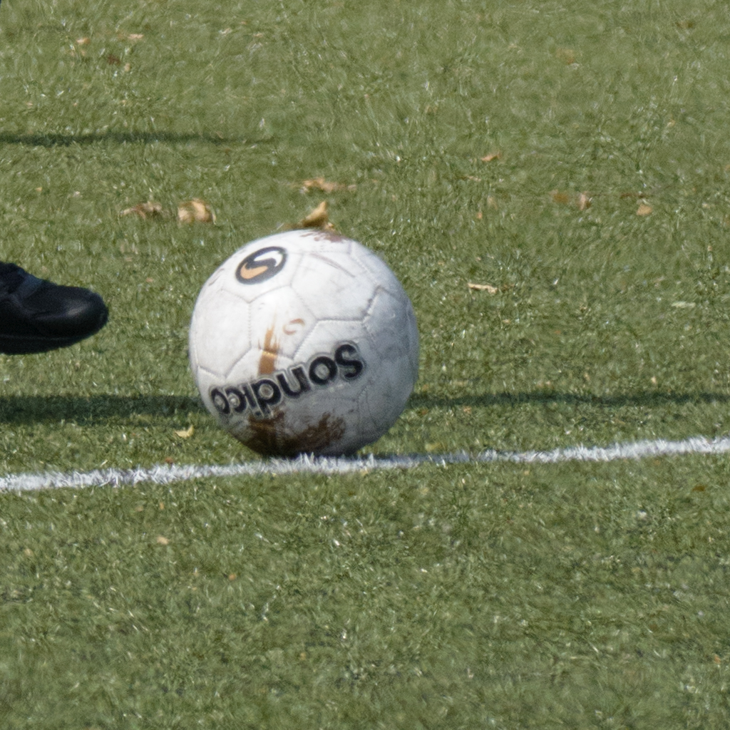

My happiness faded when I zoomed in. The grass looks like a mirage:

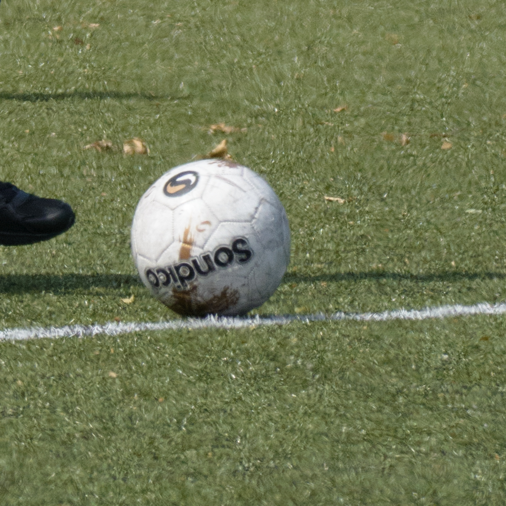

The background is probably slightly out of focus (as it should be), but this is no normal bokeh:

Thats easy to solve,dont zoom in :D
J-see
Is that artificial grass? For this shimmering to occur, the surface needs to be hotter than the air which usually doesn't happen with normal grass.
