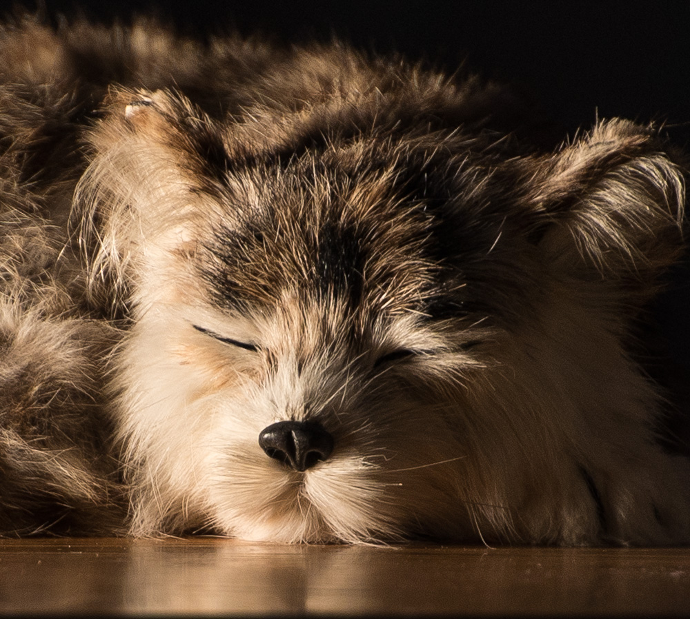

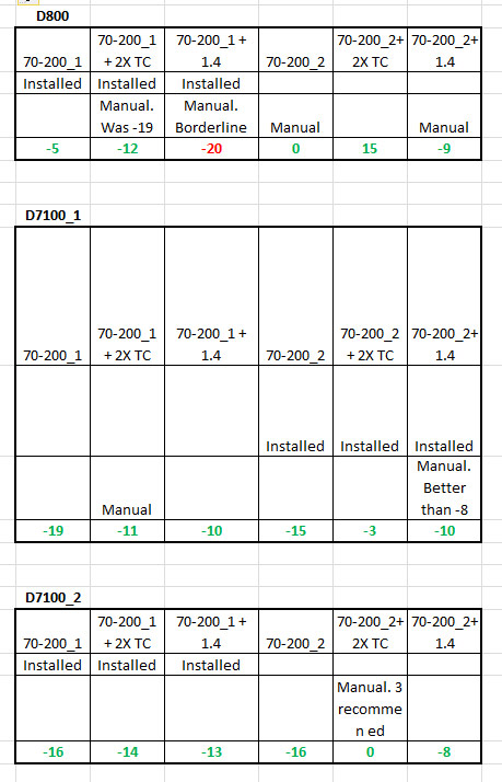

As you can see from the table, I tested three bodies with two teleconconvertors (Nikon TC-20e III and Kenki 1.4), plus two Nikon 70-200 2.8 VRII lenses. That's 18 permutations so it took a while. I initially went through the lot with the Reiken software but I wasn't completely happy with the results, so the next day I brought out the cat!! I find these stuffed toys really useful as you can aim at the nose and when you look at the results the fur gives a good idea of where the sharpness is.

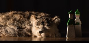

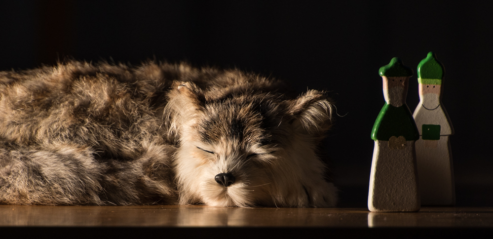

I set cat at around 20' away for the 70-200 and 70-200+ Kenko 1.4. The 70-200+ Nikon TC20e III was about 30' away from the camera. I put two small figures next to the cat, one about an inch in front of, and one about an inch behind the cat's nose. I put the 500w security light next to the cat. I metered the cat and put the cameras on a tripod in manual mode and tethered them to Lightroom via digicam control. I only used the digicam control software as Lightroom tether is unreliable for me. I then took shots of the cat using its nose as the target.
Having set everything up I fired the camera from the PC at various AF fine tune settings until I was happy with where it's focussing. The figures next to the cat help to tell if you are back or front focussing. I've set everything with a bias to focus slightly to the back as this seem more useful for real life situations. By this I mean the nose is in focus as is one inch in front of it and three inches behind.
I've included my table of results which gives an indication of how widely the settings vary. I've also included some cat pictures, although you need to see them at full resolution at 1:1 to make a judgement.
