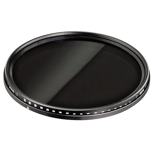

Watoh
Well.. I went to my local camera shop and ended up buying something I had not heard of before.. a Hama 'Grau Verio' ~ Variable Grad ND 2-400 (62mm with 2 stepdown rings 62-58 & 58-52)
It's very cool. I've not used it in anger yet.. but it looks very promising.
Watoh
This variable filter is AWFUL, complete waste of money.
Simply does not work on my D 600 with any of my lenses. My advice is don't touch it with a barge pole.!
