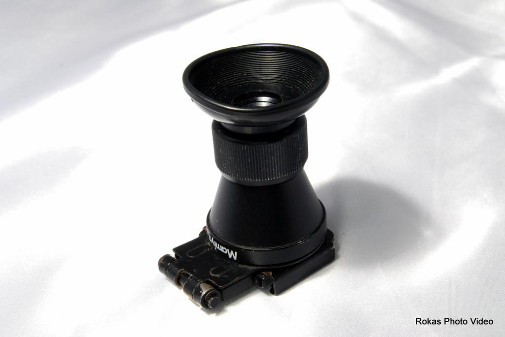

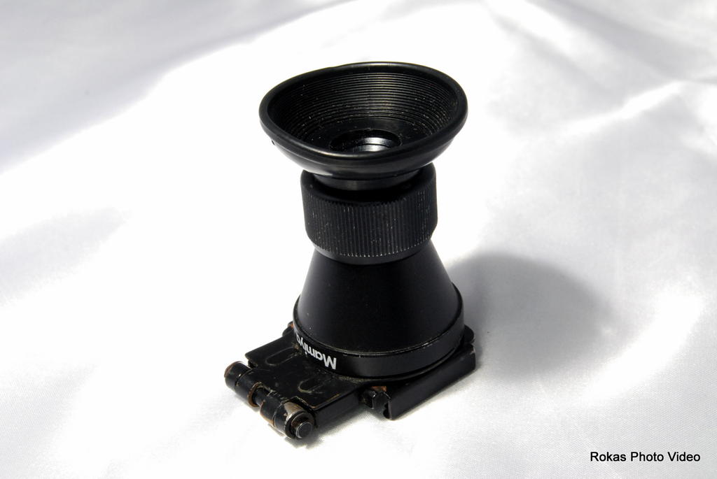

you could get one of these diopter magnifiers... They can be a bit pricey, but I'm sure there are bargains out there ...

I'll start with the fine print focusing and if then try the glasses/magnifier options as well.
