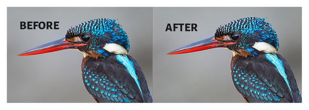

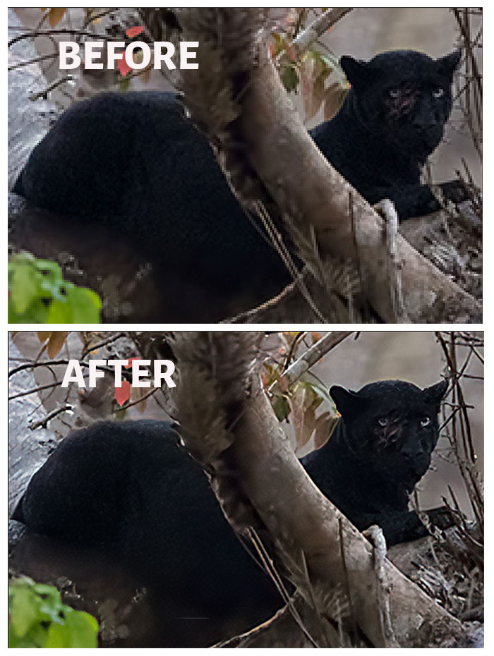

Have you seen this review from Northlight Images?
Yes, that was one of the advertisements that I saw on dpreview and one that gave me the incentive to download the demo. Did you see this on the page you linked: "Use our 15% discount code ‘Northlight’ for a specially reduced price if you buy."

I have tried the Topaz AI Gigapixel with their fee 30 day trial version. I have been using photoshop for my image enlargement needs. I had done a comparison with photoshop too and the results are pretty good.
You can see more Before After images and review samples here: Topaz AI Gigapixel Review
